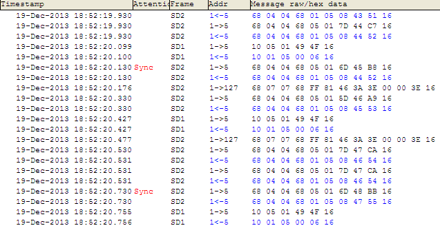

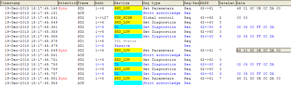

          2 screenshots for test 2
    Screenshot 1: DP data at baudrate of 93.7k and it is similar with 9.6k, 19.2k, and 187.5k.
    Screenshot 2: DP data exchange is unstable at baudrate of 500k and the situation is similar with 3M baudrate.
    Please help us with analyzing it and thank you very much. And don't hesitate to comment on and ask for more if there is anything ambiguous. Really appreciate your help.

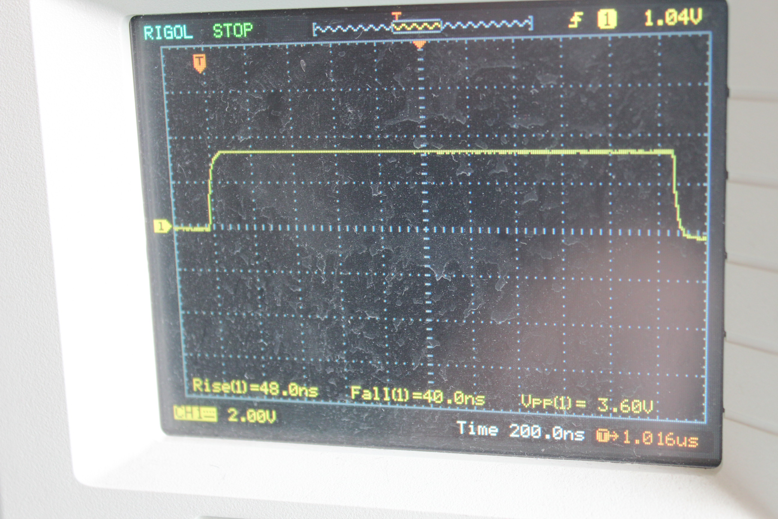

  • Mr. Thomas Mauer's suggestion:
    "Can you please measure with a scope the UART TX signal: On ISO1176/1176T:
    Measure D (UART_TXD) and set the trigger to use the rising edge of DE (UART_TX_EN). I need to see the bit timing, because I still think that this might be stilll slightly off the exact baudrate."
    Reply to Thomas:
    AM1810 Bit-time test at several DP baudrates
    • At the baudrate of 9.6k——Standard bit time: 104μs, real value in test: 108μs, Deviation is +3.8%;
    • At the baudrate of 500k——Standard bit time: 2μs, real value in test: 2.08μs, Deviation is +4%;
    • At the baudrate of 3M——Standard bit time: 333ns, real value in test: 347ns, Deviation is +4.2%.
    The above data is from DP analyser-ProfiTrace2. And the test at baudrate of 500k is carried out by both DP analyserand a scope and the results are similar.

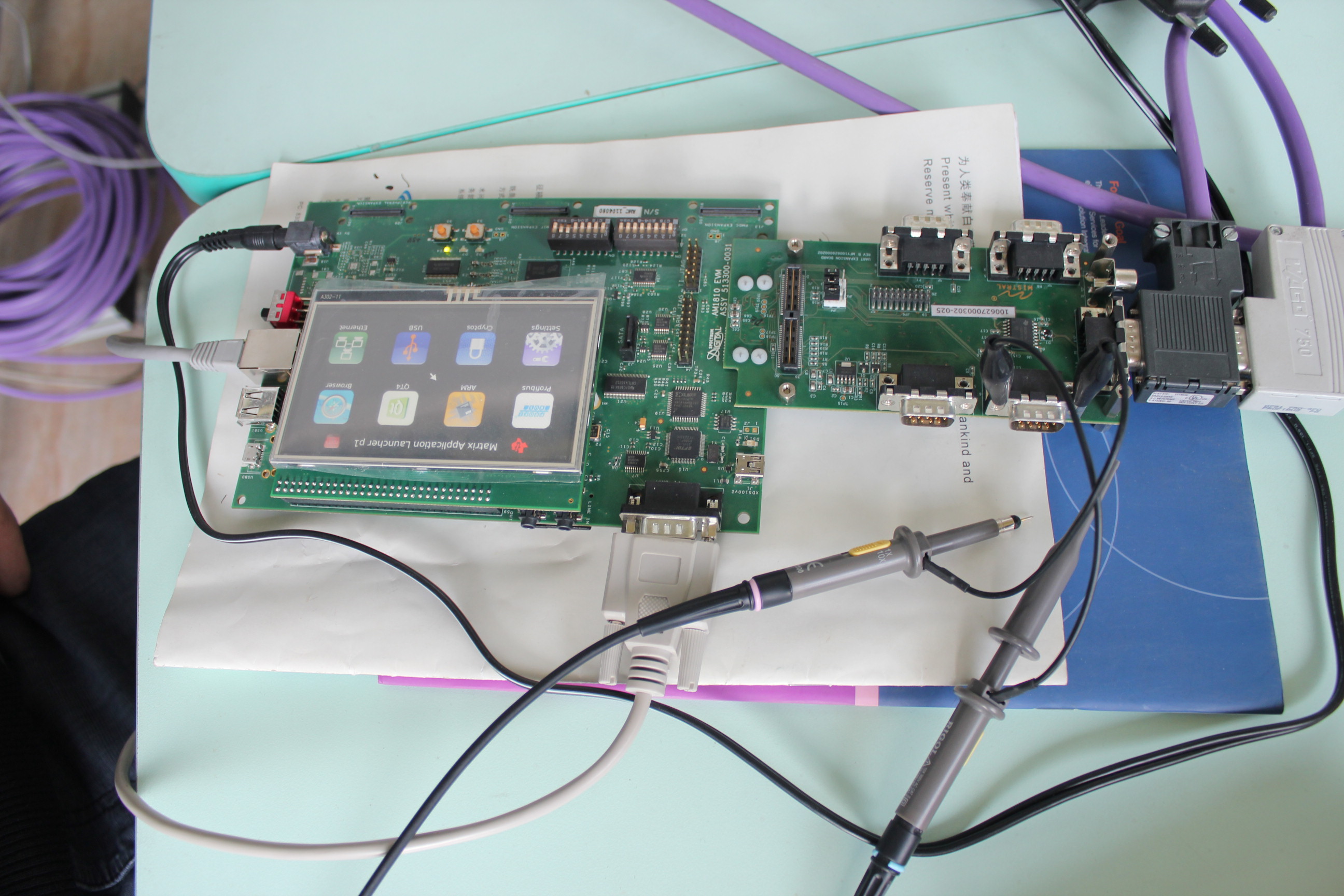

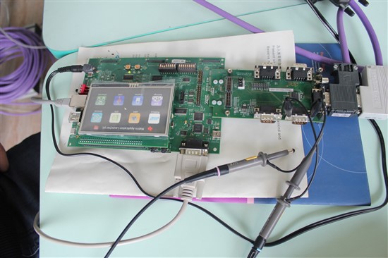

    Fig-1: Scope test At baudrate of 500K.
    Fig-2 The whole picture of the board.
    Your analysis is very important to us.  Thank you!
    Looks like UART interface is running at 150MHz instead of 156MHz required to meet the tolerance for PROFIBUS @12MBaud as Thomas M suggested.
    See http://processors.wiki.ti.com/index.php/AM1810_Frequency_Settings_For_Profibus for more details, you can verify this by looking at UBL console message when the board starts booting. UART1 used for PROFIBUS is deriving functional clock from EMIF PLL and DDR MHz numbers shall indicate this AFAIK.

  • Hi Mr. Pratheesh Gangadhar! Yes,  when we use CX1500-M310 from Beckhoff as profibus Master and AM1810 as slave, it works normally too.  But all the tests were based on sending only one byte.
    We are now testing on multiple bytes. I will update this post here once  there is any progress.
    Thank you again.
    Last day in 2013 today, hahaha.       Happy new year!
  • Hi, Mr Pratheesh Gangadhar!
    We tested on sending multiple bytes and we have a problem.
    • Test 1: ProfiTrace as Master, AM1810 DP slave, Baudrate 3M, 200 bytes data to test
    • Test 2: CX1500-M310 from Beckhoff as profibus Master, AM1810 DP slave, Baudrate 3M, 200 bytes data to test
    The results from both situation are the same as follows:
    The AM1810 DP slave can recieve 200 bytes correctly from both Masters, ProfiTrace or CX1500-M310. BUT, when AM1810 DP slave sends 200 bytes data, both Masters can only correctly recieve the 128 bytes in the front of the 200 bytes, but not for the rest bytes.
    Please help with analyzing it which is very important for us. Thank you very much!
    This indeed is a bug in the firmware, but good news is that we found a fix for the same 8640.libprofibus_dpslave.zip
    Please try with this new evaluation library and let us know the results
