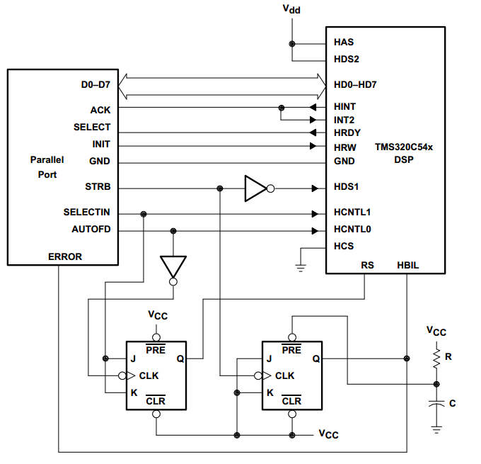

I’m looking for an adapter Parallel port to HPI port in order to communicate my PC to the C54x DSP.
So, based on TI manipulation: The TMS320C54x DSP HPI and PC parallel Interface http://www.ti.com/general/docs/lit/getliterature.tsp?baseLiteratureNumber=spra151&fileType=pdf
The communication between the PC and the ‘C5402 DSK works fine.
Now, I’m trying to do the like that for a DSP board (not DSK) (see figure).
But unfortunately doesn’t work!!
question:
Did I miss something?
or if there is another way to do it!
