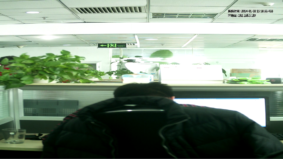

I am using the platform of DM8168.
I want to implement the image 90 degree rotation.

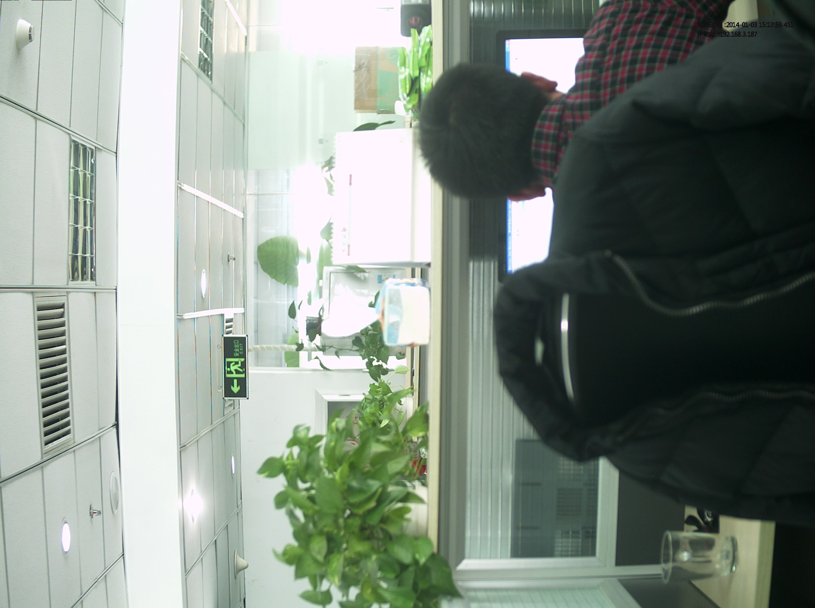

  • Attached is patch to implement rotation using tiler in SwMs link.You can refer it to understand the changes required to implement rotation.Following rotation are possible, flipX,flipY,swapXY . The patch should be applied on top of DVR RDK 4.1

  • 1,
    I have another question about the sclr link.
    The normal image(no rotationed) as follow:
    However, when I rescale the image to 1920*1080 used the sclr2, the image would be deformed as follow:
    Now, I want to modify the chain as follow:
    capture --> mpsclr --> sclr -->nsf --> sclr --> nsf --> framesout ...
    the capture output: YUV420SP, 2592*1936, non-tilered memory
    the mpsclr output: YUV422I, 1920*1080, non-tilered memory
    the sclr1 output: YUV422I, 960*1024, non-tilered memory
    the nsf1 output: YUV420SP, tilered memory, resolution is 1024*960
    the sclr2 input: YUV420SP, tilered memory, resolution is 1024*960
    the sclr2 output: YUV422I, 1024*1920, non-tilered memory
    I have a question about the sclr link, its output resolution could be 1024*1920?
