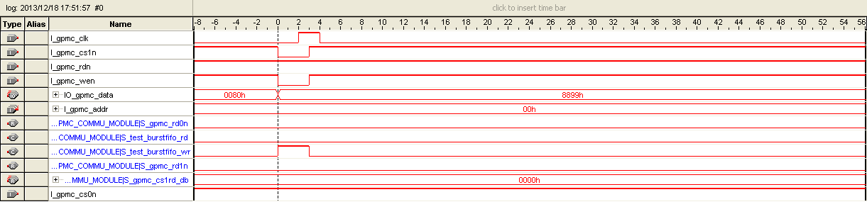

Dear , a AM3359 is on my custom board, its GPMC is connected to a FPGA.
According  to TRM 7.1.4.2.5, no "synchronous write burst access" item listed here, does it mean that AM335X GPMC doesn't support   "synchronous write burst access" ?

In fact, when I issued a 4 16bit-words GPMC burst write, the arm was hanged, and only a 16bit-word write was issued, as the following picture captured by the FPGA:
but the 4 16bit-wors is correct,as follow:
the GPMC configuration code is as follow, the chip select is cs1:
