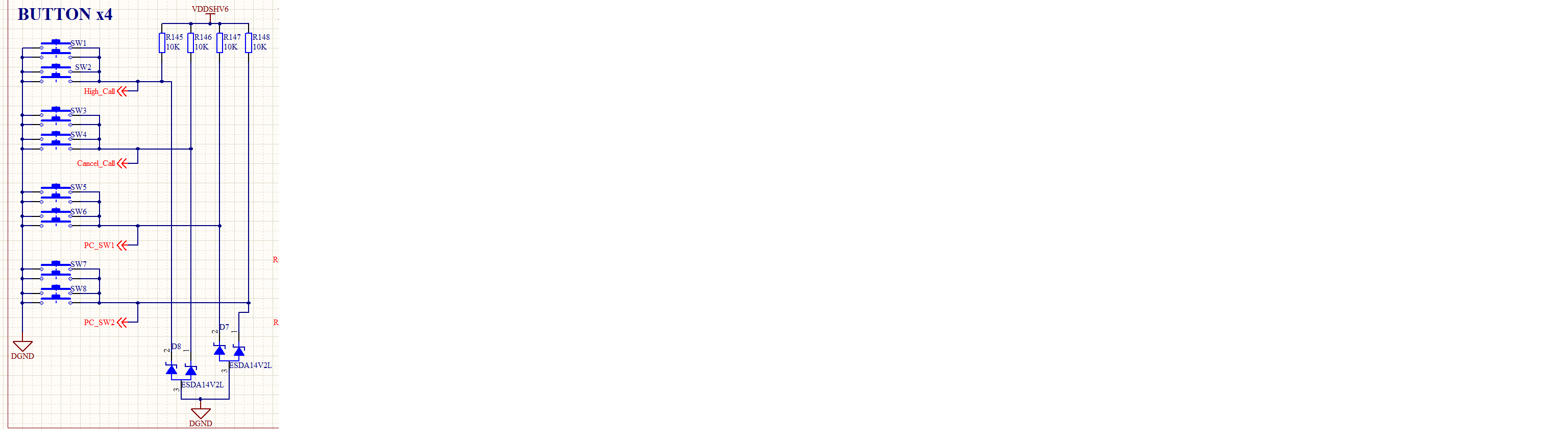

I am using Am335x for one of our products, there is an issue I concern as follows.
I am using some IO pins as inputs with 10Kohm pull-up resistor, but I found the high level is only 2.4V around, is it correct?
PC_SW1 connect to AM3352ZCZ_pin V12
Cancel_Call connect to AM3352ZCZ pin U16
High_Call connect to Am3352ZCZ pin V15
PC_SW2 connect to AM3352ZCZ pin V16
they are all config as
OMAP_MUX_MODE7 | AM33XX_PIN_INPUT_PULLDOWN   in board_am335xevm.c
