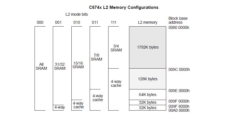

    0x0080 0000 0x0083 FFFF - 256K DSP L2 RAM
    0x1180 0000 0x1183 FFFF - 256K DSP L2 RAM
    The memMap configuration parameter defines the on-chip memory map for the device. Define the amount of L2 RAM used for L2 Cache.
    Level 2 memory (L2) can also be split into L2 RAM (normal addressable on-chip memory) and L2 cache for caching external memory locations. It is one of the internal memories of the DSP subsystem.
    L2 memory includes 256 KB of RAM. The DSP unified memory controller (UMC) allows you to configure part or all of the L2 RAM as normal RAM or as cache. You can configure cache sizes of 0 KB, 4 KB, 8 KB, 16 KB, 32 KB, 64 KB, 128 KB, or 256 KB of the 256 KB of RAM. The default configuration is 256 KB normal RAM.
    L2 memory can be configured as mapped memory, cache, or combinations of the two.
