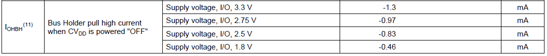

Please let me confirm the following question.
[Question]
What pull-down resister values should we use  for the pin which has bus holder function in order to change the status from "H" to "L" in view of variation of device?
I know that the datasheet has this specification as below.
Regarding to this, we should be mount the pull-down register which can flow the 1.3mA@3.3V.
However. XF pin did not change the status even though mounted this register.  As a result, we could the status by using 1.5kohms (Approximately 2.0mA).
So, I would like to know the best pull-down resistor value which can have a effect of changing the status in view of variation of device.
    What is the condition of testing this? CVDD off?

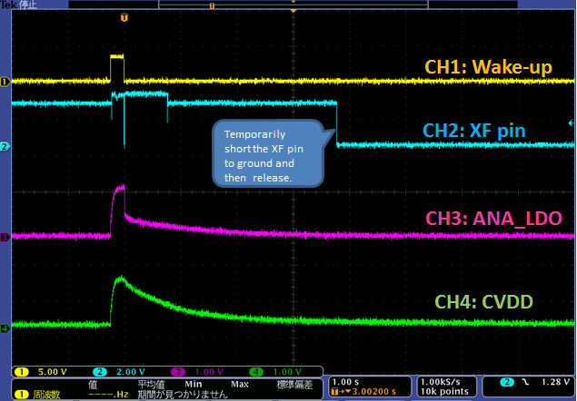

  • Hi Vasantha,
    Thank you for your response.
    I confirmed your request No.2 with using the C5515EVM.
    As a result, when to temporarily short the XF pin to ground and then release,  the XF pin changed the status from "H"  to "L".
    Also I have question for your suggestion No.1. I think that if use 750 ohms pull-down resister for this, the status will be changed because the 1.5k ohms can change the status. And if use the 750 ohms for the pull-down resister of XF pin, the current will be approximately 4mA.
    Would you please explain the reason of 750 ohm pull down resister in logical?
    I would like to know why you chose this value.
    Best regards.
    Kaka
  • Hello Kaka-san,
      Thanks for confirming on suggestion #2.
     On Suggestion #1, I had thought that you were not able to change the status to 'L' even with 1.5Kohms. So thats the reason we suggested to try with lower resistor value. sorry about that confusion.
    Will get back to you on the right resistor value. Mean while I have few more questions:
         1.  What is XF used for ?
         2. Is there any other logic on XF pin besides the pull-down resistor.
     Vasanth
