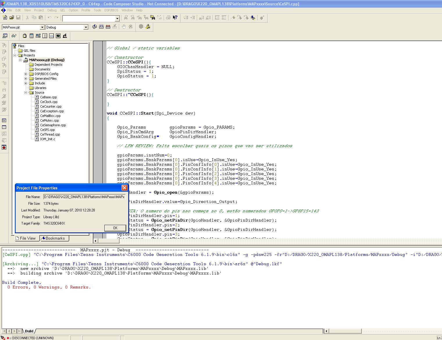

  • Hi Brad,
    But how i insert in my project the PSPIOM libraries files (a.674)?
    I'm creating this library project (MAPxxxx.pjt) to insert as "Dependent Project" in the main project.
    I already tried to add the library files (.a674) to the MAPxxxx Libraries folder....
    Luis Mendes
  • Does Project -> Add Files not work?  You should be able to add a lib file just like anything else.  Maybe it's the extension that CCS doesn't like.  Perhaps you could make a copy of that file with .lib extension.
