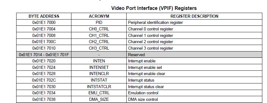

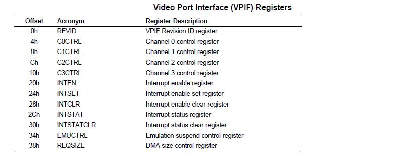

    I could not see 0x14 register address used by VPIF. Please possible mention the register name.
    For your reference, see mentioned here some of the registers are used by VPIF.
    Note: Progressive video only uses top-field buffers, the address offset per line of data is equal to hofst (CnIMGOFFSET = hofst). When capturing 10-bit or 12-bit video in the raw capture mode, the offset per line of data is doubled because of bit padding.

    I cannot access reg 0x14 description in documentation, it is stated 'reserved' as you pointed. But I can see that it's value is changing, and I guess that it might report exact error code when ERROR interrupt occurs - unfortunately, I could not find any way to distinguish:
    • For channels 0 or 1:
    – Internal buffer overflow
    – Length of EAV2SAV or SAV2EAV is not the same as the configured value
    – Bit error detected on 4th field of TRC
    I got value 0x104 for channel 0, value 0x208 for channel 1 and value 0x30c when I attach two sensors with setup described above. So I guess it indicates some errors, and I wonder if there is any documentation on that.
