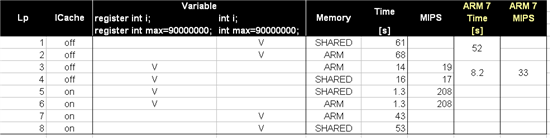

That's my first post on this forum. I wanted to share my experience with ARM9 execution time. I tested the following loop:
int i;
int max = 90000000;
for( i = 0; i < max; i++ );
with different configurations:
- ICache on/off,
- variables i and max declared as registers (register int i; register int max=90000000) or not
- program and variables placed in: shared memory/ARM memory
I use Code Compose 4.2.4. Compiler optimization was switched off. The core runs on 300MHz
What I did not test yet, is the influence of data cache. I'll update, once I have more free time.
The results are in the attachment.
When the variables are declared as NOT registers, the loop is unrolled as follows:
$C$L1:
LDR           R0, $C$CON1
LDR           R12, [R0]
ADD           R12, R12, #0x1
STR           R12, [R0]
LDR           R12, $C$CON2
LDR           R0, $C$CON1
LDR           R12, [R12]
LDR           R0, [R0]
CMP           R12, R0
BGT           $C$L1
The variables i and max are retrieved from memory each iteration, compromising the performance.
When variables i and max are declared as registers, the loop unfolds as:
$C$L1:
ADD           R12, R12, #0x1
CMP           R4, R12
BGT           $C$L1
what eliminates the need to grab to the memory, giving considerable boost.
Conclusions:
1) The execution time for extreme cases differs by a factor of 50!!!
2) Observe assembler code to pinpoint bottlenecks.
Best regards
Przemyslaw Baranski

    1) For some cases I calculated MIPS measure and also compared results with ARM7 microcontroller clocked at 55MHz, the program being fed from from RAM. The oldie ARM7 (@55MHz) seems to outperform ARM9 (@300MHz) with the latter not using ICache.
    2) Regarding ARM9 on OMAP-L138, some people say that running program from ARM memory should give better results than from shared memory. The results shows however sth else. I guess, running from ARM memory might bring better results when the SCR is being used by other peripherals and thus access to shared memory is queued.
    Best regards
