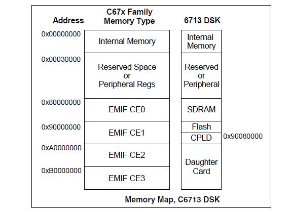

I am using tms320c6713 dsk with ccs v3.3. Presently EMIF port has been used as a output pins and interfaced with LCD successfully. But i want to use this emif port as a input & output at a time in same program code. I don't know what is the exact procedure to use EMIF port as a input. I am trying in some different way, but failed. My execution program for EMIF port as a output pins has been given below.

#define ADDRESS 0xA0000000
#define GBLCTL 0x01800000
#define CE2 0x01800010
extern int *output11=(int *)ADDRESS;
int *ce2 = (int *)CE2;
