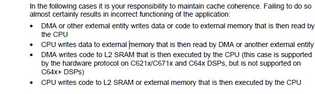

A cache-based memory system, multiple copies of the same memory location may exist simultaneously, a protocol must be followed that ensures that requestors do not access an out-of-date copy of a memory location.
Since cache cannot be used for code or data placement by the linker, all sections must be linked into SRAM or external memory.
Please see the wiki articles, this will give more details of cache memory.
http://processors.wiki.ti.com/index.php/Cache_Management
http://processors.wiki.ti.com/index.php/Enabling_64x%2B_Cache
http://processors.wiki.ti.com/index.php/Cache_Visualization
