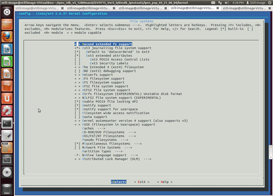

UBIFS error
We are using MT29F8G08ABABA in our DM365 based custom board.
We are using NAND boot.
RootFS is in UBIFS format,
Below is basic achitecture of the NAND.
I am using following commands to create ubifs,
$(UBIFS_PATH)/mkfs.ubifs -r  $(TARGET_FS) -m 4096  -e 520192 -c 75 -o ubifs.img
$(UBIFS_PATH)/ubinize -o $(SYSTEM_CFG)_$(HARDWARE_CFG)_ubifs -m 4096 -p 512KiB $(HARDWARE_CFG)_ubinize.cfg
Then i put this ubifs to NAND using following commands,
loady 0x82000000 ---> ubifs is loaded to RAM
nand scrub 0x1800000 0x2800000
nand erase 0x1800000 0x2800000
nand write 0x82000000 0x1800000 0x2800000
and when i boot the kernel there is error while detecting UBIFS from kernel,
Below is kernel log for the same,

[    1.206107] NAND device: Manufacturer ID: 0x2c, Chip ID: 0x38 (Micron )
[    1.214915] Bad block table not found for chip 0
[    1.221181] Bad block table not found for chip 0
[    1.225835] Scanning device for bad blocks
[    1.621947] Creating 7 MTD partitions on "davinci_nand.0":
[    1.627505] 0x000000000000-0x000000c00000 : "bootloader"
[    1.639165] 0x000000c00000-0x000001400000 : "params"
[    1.650851] 0x000001400000-0x000001800000 : "kernel"
[    1.662507] 0x000001800000-0x000004000000 : "filesystem1"
[    1.674677] 0x000004000000-0x000004800000 : "data1"
[    1.686597] 0x000004800000-0x000007000000 : "filesystem2"
[    1.698564] 0x000007000000-0x000040000000 : "data2"
[    1.711909] davinci_nand davinci_nand.0: controller rev. 2.3
[    1.721883] UBI: attaching mtd3 to ubi0
[    1.725771] UBI: physical eraseblock size:   262144 bytes (256 KiB)
[    1.732471] UBI: logical eraseblock size:    256000 bytes
[    1.737910] UBI: smallest flash I/O unit:    2048
[    1.742797] UBI: sub-page size:              512
[    1.747451] UBI: VID header offset:          4096 (aligned 4096)
[    1.753616] UBI: data offset:                6144
[    1.759413] UBI error: validate_ec_hdr: bad data offset 8192, expected 6144
[    1.766555] UBI error: validate_ec_hdr: bad EC header
[    1.771733] UBI error: ubi_io_read_ec_hdr: validation failed for PEB 0
[    1.778790] UBI error: ubi_init: cannot attach mtd3

[    1.999486] VFS: Cannot open root device "ubi0:rootfs" or unknown-block(0,0)

Now my doubt is why kernel  is reporting physical eraseblock size as 256KiB? from architecture of NAND it looks to be 512KiB.
dm368_ubinize.cfg content is as follows,
[ubifs]
mode=ubi
image=ubifs.img
vol_id=0
vol_size=37888KiB
vol_type=dynamic
vol_name=rootfs
vol_flags=autoresize
Any suggestions/pointer for the errors ?
Thank you in advance
  • Ankur,
    Can you check by the flashing the ubi image from kernel using ubiformat after booting through NFS or SD? Follow these steps.
    1. First you should have your rootfs as a tar ball in your SD card or NFS from where you mount the filesystem.
    2. Boot up the device and the filesystem from NFS or SD card according your preference.
    3. Boot it up and login. Hope you have all the required command binaries like "flash_erase" etc in your filesystem. If not take the default arago filesystem image that comes with the SDK package.
    4. Follow the steps below
    $ flash_erase /dev/mtd4 0 0
    $ ubiattach /dev/ubi_ctrl -m 4
    $ ubimkvol /dev/ubi0 -N rootfs -m
    $ mkdir /mnt/nand
    $ mount -t ubifs ubi0:rootfs /mnt/nand
    $ tar xvf rootfstar.gz -C /mnt/nand
    5. Change the bootargs like below for booting from UBIFS.

  • Hi Titus,
    In kernel version 2.6.37, YAFFS option is not available in menuconfig itself,
    I think i have to either go with ubifs or some other read-write file system.
    Here is screenshot of menuconfig.
    Any suggestions ?
    Ankur
