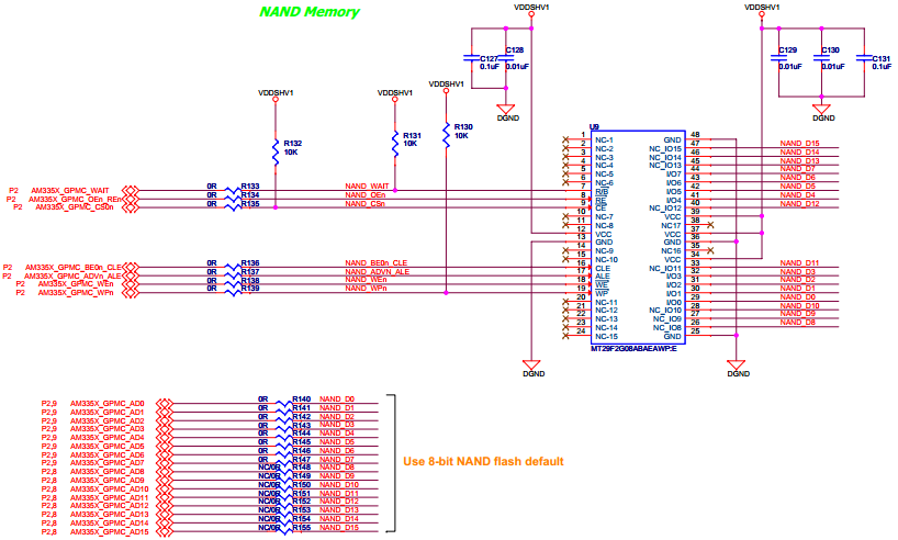

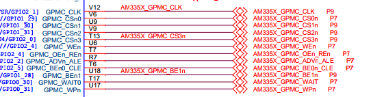

    Please provide information about the state of your SYSBOOT pins (0-15) in both cases, NAND boot and UART boot? Are you only changing SYSBOOT pins 0-5 ?
    Please also provide information about which processor pins are you connecting to the NAND flash? The WAIT signal?
    Miroslav
  • My  SYSBOOT pins  from  bit 15 to bit 0 in both cases are 01000000 00000100.
    The information about processor pins connected to the NAND flash,Please check the pictures,as follows :
