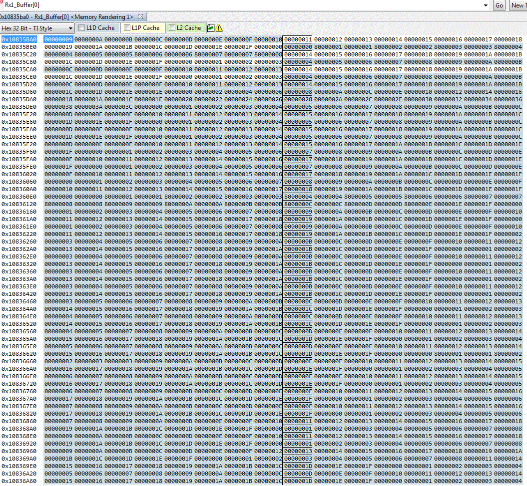

  • Hi Steven,
    Our CLKX and CLKR are derived from a single source, and FSX and FSR also from single source.  Both are locked!
    Have you tried  EDMA3 with McBSP which is running 32 TDMs at abour 50MHz?
    Attached is the memory display of part buffer of EDMA3 receive buffer.  We feed all 32 TDMs (channels) with channel identification 0x00 to 0x1F.  Please note the missing data.

  • Steve,
    I think McBSP module has been verified working with internal data clock and internal frame sync clock around 50MHz and 128 channels. But I do not have the code and platform to verify now.
    If you would like, please share your McBSP/EDMA configuration code here that all the TIers and community members could help with reviewing to see if anything is missing in the code first. Thanks.

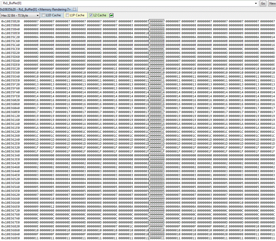

  • Hi Steven,
    I am attaching the memory dump for McBSP/EDMA3 receive buffer.  Our test hardware send contents as channel  number, such as value 0 in channel 0, value 1 in channel 1, ... value 0x1F in channel 31.  This receive buffer is EDMA sort output.  It should be two rows (32 values) for each channel.
    As you can see, 0x13, 0x14 and 0x16 and 0x17 are correct, missing 0x15.   McBSP stream comes in as 0, 1, 2, ... 31, 0, 1, 2, 3, ... continuously.  How could it miss 0x15 for every frame?    It seems like EDMA3 problem.  What could it be wrong?

  • Hi Steven,
    Have not heard from you for a while.  Hope you are still working on my EDMA3/McBSP issue.
    After more testing, I discover that using L2 and MSMC memory make big difference.  When using L2, receive buffer show lose complete 32 bit values and corrupted values.  But when using MSMC, receive buffer only show corrupted value, no lose of complete 32 bit values.
    What is the operational difference for EDMA3 to access L2 and MSMC?
