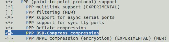

Hi Renjith:
Thanks for your reply.
I had config PPP enable:
And In USB Serial Converter support, I had enable:
USB Generic Serial Driver
USB driver for GSM and CDMA modems
After rebuild kernel, it is ok , because when I go into menu setup, the config is exist.
But when I rebuild RDKDVR 4.0, and go into KERNEL menu setup, the config is fail!
All I set is disable.
Is other config should selected?
The kernel config will get reset to default DVR RDK config as the config file is copied from default DVR/EVM config if you do make sys_all. To build with modification change the configuration and rebuild only the uImage.Refer the following posts:
http://e2e.ti.com/support/dsp/davinci_digital_media_processors/f/717/t/270263.aspx
http://e2e.ti.com/support/dsp/davinci_digital_media_processors/f/717/t/276031.aspx
Hi Badri:
Thanks very much!
I had build kernel independent! And then make menuconfig, I can find that the PPP config is exist!
But when in RDKDVR, make sys or maye sys_all, then in kernel, make menuconfig ,the PPP config will be disable.
