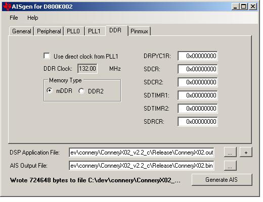

  • Ok, I've run the experiment suggested and essentially here is my problem: My code image is around 600KB, so it is too big to completely fit into internal RAM. So what's happening is that I'm trying to run code out of DDR and it's not configured properly. I think I need to have the AISGen tool configure the DDR for me. I'd like to configure DDR to run at 132MHz, so is there a quick reference somewhere where someone has already determined the default register values? The registers in question are DRPYC1R, SDCR, SDCR2, SDTIMR1, SDTIMR2, and SDRCR.  Attached is a screen capture of the DDR tab of the AISGen tool for reference.
    Thanks in advance.
  • Nick,
    You can reuse the values in the GEL file for the EVM for now.  For your final board, you will need to tweak the settings based on the DDR that you end up using.  There is a spreadsheet available to help with this once you get to that step.
    http://wiki.davincidsp.com/index.php/Programming_mDDR/DDR2_EMIF_on_OMAP-L1x/C674x
    Gus
  • Just so I'm completely clear on these registers, the first register in the AISGen tool is DRPYC1R, and I can't find this in my GEL file. Is this the control register (DDRCTL in the GEL)?
  • Yes, that's right.  I went through the other registers to be sure there were no other discrepancies.
    aistool        offset    gelfile
    drpyc1r        e4        ddrctl
    sdcr             08        sdcr
    sdcr2           1c        sdcr2
    sdtimr1        10        sdtimr1
    sdtimr2        14        sdtimr2
    sdrcr             0c        sdrcr

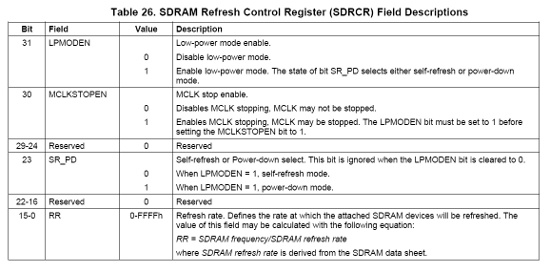

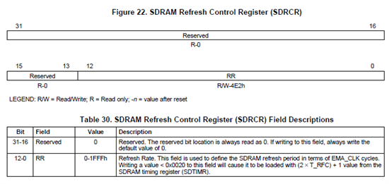

  • Good post, fellas - lots of interesting info about DDR2 configuration here. Heres an open question... in the GEL file for LogicPD's EVM, the last line in the configuration algorithm disables self-refresh:
    EMIF3A_SDRCR &= ~0xC0000000;  // disable self-refresh
    They do this by setting RR to zero. 'But why?' Dont we want self-refresh to keep the data fresh?
  • No, "self refresh" means that the DDR2 is refreshing itself.  That mode of operation would only be used in a case where we were putting the 6748 into some kind of idle mode.  In normal operation the DDR2 controller of the 6748 is responsible for refreshing the DDR2.
  • Brad, thanks for the quick reply. I was under the impression that the control register was being assigned '0xC00000...', which would have meant that self-refresh mode (SR_PD bit) is being activated and the refresh rate was being set to 0 - but a quick websearch reveals that &= is a bitwise AND and the ~ a bitwise COMPLEMENT and thus the command
    in reality assigns LPMODEN and MCLKSTOPEN to 0 without affecting other bits.
  • Sorry, I was just responding generically about what self-refresh is.  I didn't even look at the actual registers.  Now I'm confused though.  I just pulled out the EMIFA User Guide and those bits don't appear to even exist.  Here's a screenshot.
  • DDR2 is not supported through EMIFA.  It's supported through the DDR2/mDDR controller.  See this guide:
    http://www.ti.com/litv/pdf/sprugj4
    Wrt to the original question, have you tried the LogicPD BSL functions for configuring DDR?  You can do so by commenting out the "Use_GEL" line in the examples shipped with the BSL install package.
  • Check the DDR Memory Controller user guide! ;-)
  • Ah, the variable "EMIF3A_SDRCR" made me look at the EMIFA User Guide.  Go figure...  :)
    I don't understand what your confusion/question is -- clearing those upper 2 bits "wakes up" the DDR controller and so the DDR itself is no longer in self-refresh mode.
  • Brad - no, I understand this now. My confusion was with the &= and the ~ operators. Issue resolved! Thanks :)
