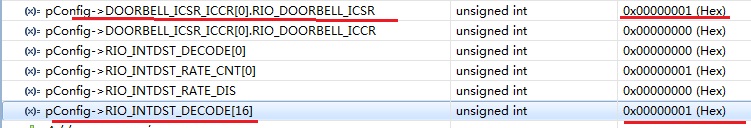

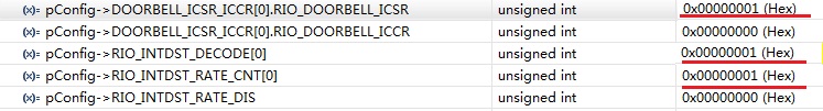

  • Hi,Travis:
    I guess my issue comes from two sides.The first side is that consumer cannot receive doorbell packet from producer after producer success to send data to consumer and so ISR cannot be fire.The other side is interrupt configuration issue which means that since consumer receiver doorbell from producer but ISR still cannot be fire because of interrupt configuration issue.
    So, I do some experiments to check the fact.
    1.
    Can consumer receive doorbell from producer?
    I do two tests one by one.First I map Doorbell reg0 and bit0 to INTDST0,Second I map doorbell reg0 and bit0 to INTDST16.When producer succeed to send data packet and consumer see that data is available,I view the some registers of SRIO like below:
    INTDST0
    You can see that doorbell[0].ICSR = 0x0000 0001 and RIO_INTDST_DECODE[0] = 0x0000 0001.Can I consider it that consumer has receive the doorbell packet from producer after data is available ?
    INTDST16
    Doorbell[0].ICSR = 0x0000 0001. RIO_INTDST_DECODE[16] = 0x0000 0001.
    Likely, Does it mean that consumer have receive doorbell from producer?
    I think it means. So,I think consumer have succeeded to receiver doorbell from producer.
    2.
    Is it interrupt configuration issue?
    My source code with regarding to interrupt configuration have been proved in past example .
    My interrupt configuration code is ported from
    pdk_C6678_1_1_2_5\packages\ti\csl\example\cpintc .
    Among these examples I have also succeed fire interrupt without any problem.So,I think
    Interrupt configuration is good and no problem.
    So, above all,Can you give me some advice ?  As to tx LSU completion code ,I can dump,Since once I wait for LSU completion code on producer.it return 1. That means that Transaction Timeout occurred on Non-posted transaction.
  • steve zhang said:
    1.
    INTDST0
    Yes, that is correct as long as you didn't manually write the ICSR bit locally on the consumer as you indicated earlier in the thread.  This is good.  The doorbell is reaching the consumer and setting the interrupt bit. Since you are using INTDST0, the RIO_INTDST0_RATE_CNTL register must be written for the interrupt to fire outside of the peripheral.  The pacing register needs to be written each and every time the interrupt needs to fire, so write it during intialization before any packets are sent, and then also every time the interrrupt ICSR bit is cleared so the next interrupt can fire.
    steve zhang said:
    INTDST16
    Yes, same as above, except there is no need to write the pacing register.

  • Hi,Travis:
    I follow you advice and try with event 20 with vector id = 9.but still fail.
    I have verified that interrupt routing and configuration is no problem.Because I view
    the register of INTMUX2 INTSEL9 = 0x14 = 20 which is the right number.
    So,I believe interrupt routing and configuration is ok.
    Since,I want to ask you how can you make sure doorbell with reg=0 ,bit=0 valid = 1
    must trigger INTDST16 event? I cannot see that anyway .How can you prove that with details?
    Another,When you set doorbell route like below :
    CSL_SRIO_RouteDoorbellInterrupts (hSrio, 0, 0, 0);
    Does it mean that you route doorbell reg=0,bit=0 to INTDST0 instead of INTDST16?
    When I try with CSL_SRIO_RouteDoorbellInterrupts (hSrio, 0, 0, 16) it still doesn’t work.
    If you send a doorbell with the info field 0x0000, it will set doorbell_ICSR0 bit 0 = 1.  In order to route this to the INTDST16, you must set RIO_INTERRUPT_CTL(0) = 0b0.  Then you must set RIO_DOORBELL0_ICRR(3:0)=0b0000.
    The code snippet above should do that.
    It all depends on how you have the RIO_INTERRUPT_CTL(0) set.  The below is from the user's guide where he value column represents the programming of the ICRR register.
  • Hi,Travis:
    As you said,SRIO routing and configuration is no problem.Meanwhile,interrupt routing
    and configuration is also ok .Since,Everything is no problem,What's the matter?
