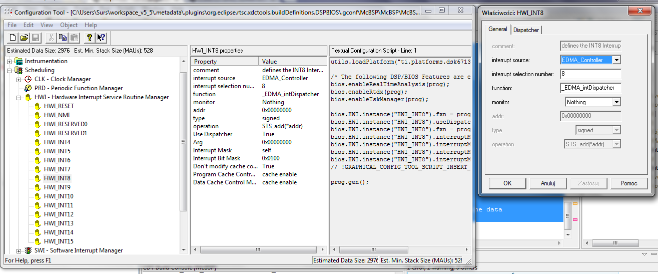

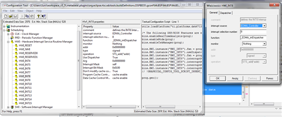

I configured interrupt using Configuration tool:
I set breakpoint in edmaHwi function but program never gets there. What can be source of this problem?
