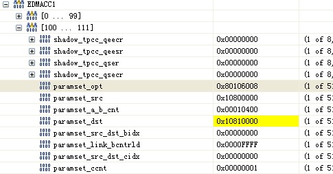

    1. Firstly, I set all the src and dst address in L2.
    Uint16 * srcBuff1 = (Uint16 *)0x10800000;//src in L2
    Uint16 * dstBuff1 = (Uint16 *)0x10810000;//dst in L2
    Then I make a breakpoint in the manual trigger code. And I get the param set like the pic below
    After triggering, the param does not change.
    In dst, I can get the data from src.

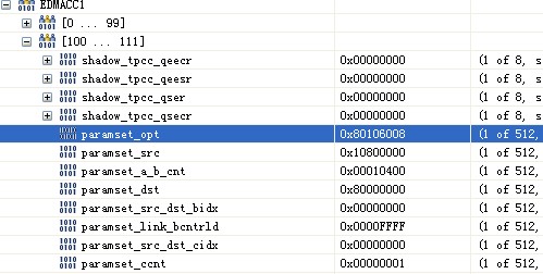

    2. Secondly, I set the src in L2 and dst in DDR3 like
    Uint16 * dstBuff1 = (Uint16 *)0x80000000;//dst in DDR3
    Then I also make a breakpoint in the manual trigger code. And I get the param set like the pic below
    After triggering, the param does not also change.
    In dst, I can not get the data from src!!
    I don't think my configuration of param set is wrong. Because the EDMA from L2 to L2 is OK. Just the EDMA from L2 to DDR3 or DDR3 to L2 or DDR3 to DDR3 fails.
    Maybe there is mechanism that protect the DDR3 from the operation of EDMA?
    Thank you again! Hope you help me!

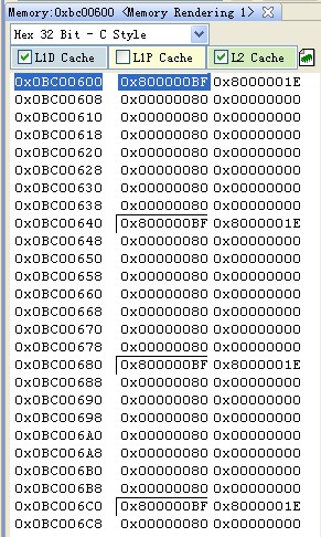

  • Hi Aditya,
    Thank you first for your reply!
    1. I test the L2->L2 tranfer and L2->DDR3 transfer independently.
    2. I saw the SES MPAX regs just before triggerring L2->DDR3 EDMA like pics below
    I think these values are just the reset values.
    No I doubt that there are some problems in the configuration of DDR3 controller.
    In my board, the keystone DSP connects with four DDR3 memory chips. There are four MT41J128M16(16M*16*8 Banks) in my board.
    RAM 0~1: connect with the low 32bits of data line and the CLK1p/n and CKE1
    RAM 2~3: connect with the high 32bits of data line and the CLK0p/n and CKE0
    That means I use the CKE0 and CKE1 in the same time.
    In the GEL file, I set
    NM=0, ROWSIZE= and EBANK=1(means using the CKE0 and CKE1 in the same time)
    But the leveling fails!!
    In this situation, I test the DDR3 using the code like
    *(DDR3_BASE_ADDR++)=0xABCD;
    And I can get the results in the Memory Broswer.
    But if I use the EDMA to transfer data from DDR3 to MSMC, some data will be fault.
    if I use the EDMA to tranfer data from DDR3 to DDR3, I can not get data in the dst.
    So maybe the leveling problems make the EDMA can not write or read the DDR3???
