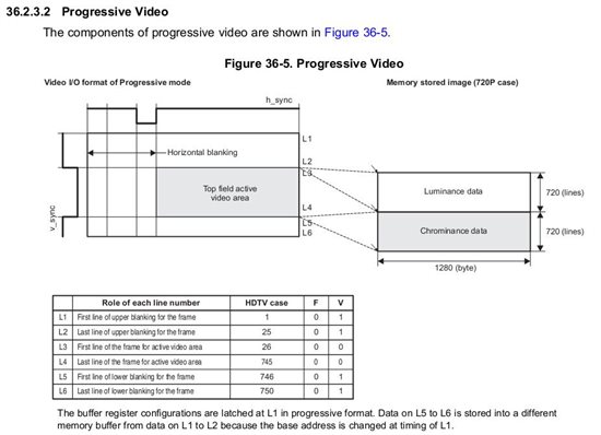

    The SMPTE 296 M mode requires the same clock control for the VPIF module as in BT.656 and BT.1120modes. The video input clock source is 74.25 MHZ.
    Please refer Table 36-8 page no 1766 in the Technical reference manual for the register configuration on SMPTE 296M Input/Output.
    you need to operate the tc(VKI) Cycle time ,VP_CLKIN0/1 at 13.3 ns ( 75 MHz) that is the minimum clock requirement to achieve SMPTE 296 mode and make sure you're CPU core voltage should be 1.3V or 1.2V

    6. I am trying to interface OV2643 to OMAPL13X. I'm able to read the product id of the device via I2C
    The signals outputted by Vsync and Href lines are in accordance with OMAPL13X VPIF document.
    The PCLK signal (i.e. commonly fed to VP_CLKIN0 and VP_CLKIN1) are at 48Mhz
     , while master clock fed into the image sensor from UI board of EVM development kit  is 24Mhz
    I'm trying to capture raw image data in progressive mode with 1280 * 720p format
