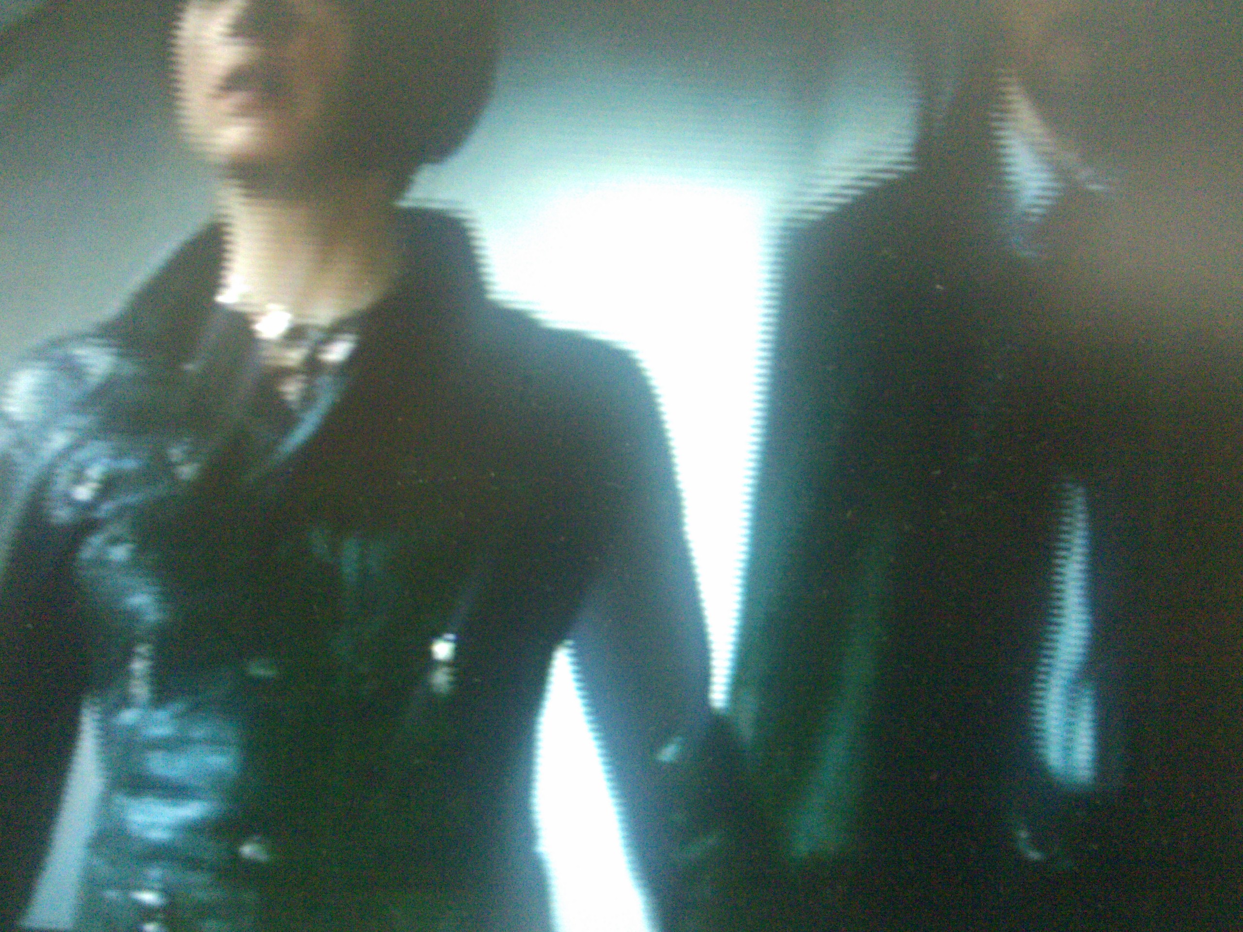

I am working with Mistral EVM on DM3730, i am using ti-dvsdk_dm3730-evm_4_02_00_06, when i am running the example saMmapLoopback with NTSC input via CVBS or S-VIdeo connectors, my output is via DVI to LCD. On the LCD display i see horizontal stripes looks like interlacing effect. Is there is a way to avoid this problem?

  • Hi Tsvetolin,
    Please see the stripes in the photo from the screen. This is with CVBS input of NTSC video with the command
    ./video_loopback_copy_dm3730.x470MV -O dvi -I composite
    Gabi
  • Gabi,
    Now when I see the photo I understood the issue. These stripes due to interlaced input video signal. The issue is more noticeable when playing video with fast moving objects. This explain why I didn't observed the issue in my previous test playing static pictures with PAL.
    This is some kind of disadvantage of the current implementation of the TVPxxxx driver but I'm wondering that this effect is appeared so strongly or the posted image is zoomed.

  • Hi Tsvetolin,
    Thanks for your quick respond, the photo is a little zoomed but the stripes are very noticeable even without zooming.
    Is there anything i can do to avoid these stripes? My product will be unacceptable this way.
    Gabi
  • Hi Gabi,
    It is possible to make some improvement of the video output if you implement some deinterlacing algorithm in the TVP5xxx driver but it seem very complicated work. This is the main disadvantage of the current implementation.
