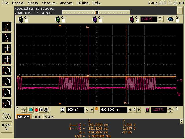

CPU core operates on freq = 1000 MHz. So SPI module clock = Sysclk7 = CPU clock / 6 = 167 MHz. SPI register settings are:
SPI_DAT1 = 0x10010000;
SPI_DELAY = 0x0;
SPI_FMT0 = 0x00010308;
SPI output clock = 167 / (3+1) = 41,7 MHz.
With these settings we have behavior shown on the figure (only SPI output clock is shown):

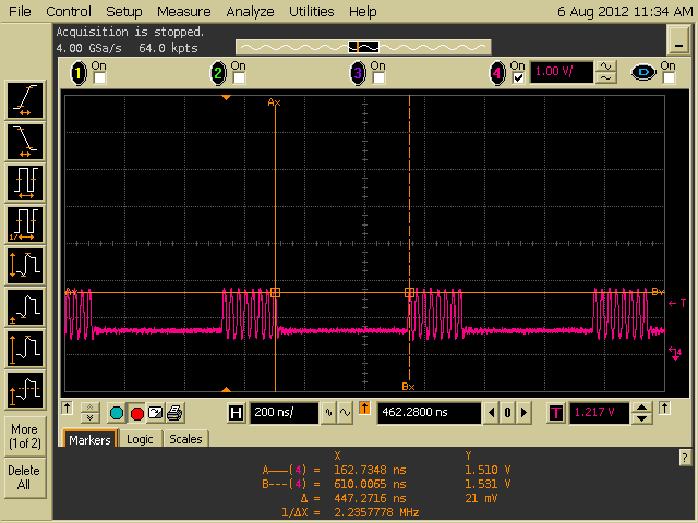

The problem is: a lot of time between transactions - approx. 450-500 nS.
The only place in program where it can "idle" a lot of time is:
        while ( SPI_SPIBUF & ( CSL_SPI_SPIBUF_RXEMPTY_MASK ) );
So, the question is: why this flag does not clear so long?
P.S. With 16-bits mode transactions behavior is the same:

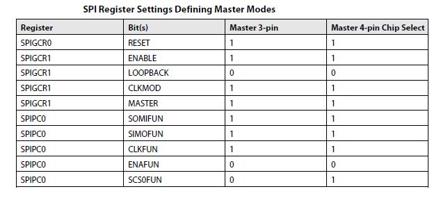

    The C6678 device is supported only in Master mode for SPI. This device supports two type of SPI configuration(3-pin and 4-pin). Please check the configuration used by you on board.
    Here, you are using 16-bit Receive buffer register(SPIBUF). Yes, the SPI clock (SPICLK) is derived from the SPI module clock. You can use the SPI pin control register(SPIPC0) to configure the SPI for 3-pin or 4-pin.
    You are correct, can configure the master delay options using the SPI delay register(SPIDELAY) in master mode.
    If you are configured as a 4-pin with chip select mode, this delay is controlled by the T2CDELAY bit in SPIDELAY.
    It can be configured between for 1 and 256 SPI module clock cycles.
