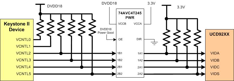

    Section 10.2.4 of revE data manual refers to VCNTL[3:0] signals for the 4-pin 6-bit VID interface.   However, Tables 8-29 and 8-31 refer to using VCNTL[5:2].    Also, the K2H_K2EVM eval board schematic only connects VCNTL[5:2].
    Assuming the eval board is correct, would you provide correction for section 10.2.4, so we know which pins to monitor for the 4-pin 6-bit VID interface?

    Section 10.2.4 of the data manual is incorrect. When connecting the 66AK2H12 in 4-pin 6-bit dual-phase mode, VCNTL[5:2] should be used as specified in Table 8-29. The figure below illustrates the connection between the 66AK2H12 and a UCD92xx power supply controller, including the level translation logic.
