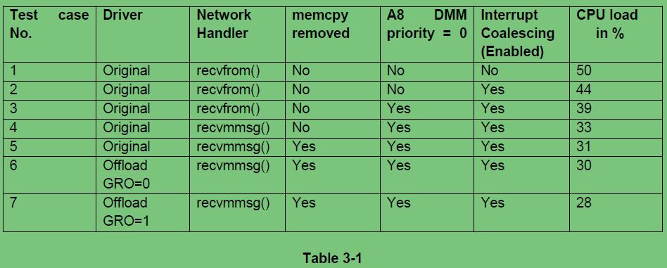

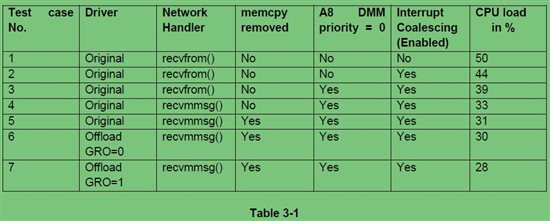

  • hello Yogesh,
      thanks for your reply.
    Q1.
    By checking following table in DM81xx_DVR_RDK_Network_Stack_Optimization_Techniques_for_Multichannel_NVR.pdf
    It looks like the reduction of CPU loading by Offload is 31-28 = 3%. Right?
    Q2.
    by following description in DM81xx_DVR_RDK_Network_Stack_Optimization_Techniques_for_Multichannel_NVR.pdf
    Live555 stack has been modified to use recvmmsg(). If OPTIMIZE_NETWORK_READ_HANDLER
    is defined in live555\liveMedia\Makefile, recvmmsg() is used for data reception, otherwise it uses recvfrom()
    Does it mean the recvmmsg() API was implemented in tool-chain from rdk4.x?
  • For #1 No you can not conclude that. First of all it is 3% improvement  on 31% so actually it is  9-10% improvement (on 100%). e.g. dropping down from 50%-28% is not just 22% improvement it is 44% gain in terms of cycles. Also, If you enable offload  at test case 1 I believe result will be different.
    For#2 No recvmmsg() is already supported as a unix system call like other system calls, we just modified live555 to change the handler which was using recvfrom() and made it use recvmmsg() for performance reasons.
