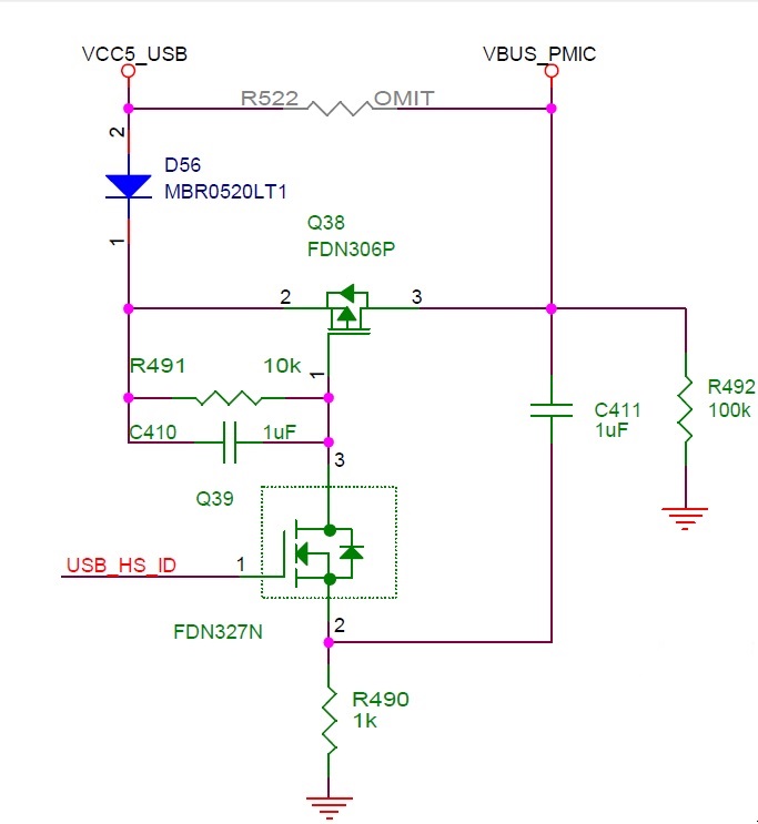

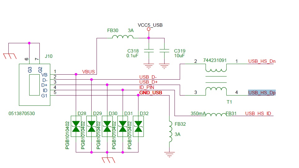

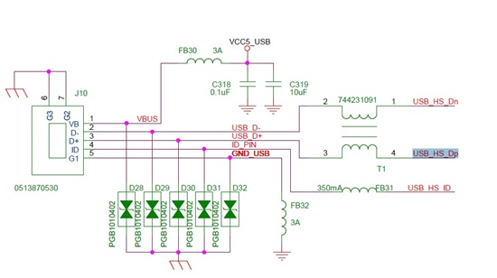

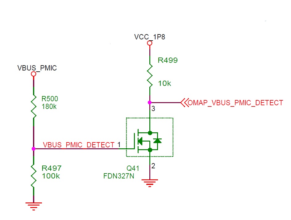

  • WinCE is not supported on this forum, there is a dedicated forum for it: http://e2e.ti.com/support/embedded/wince/default.aspx. However, could you post the USB section of the schematic? Maybe there is a hardware issue.
  • Thanks.
    Please find the USB section.
  • Comments from the factory team below:
    For host mode, the cap should be >= 120uF. But 10uF or 4.7uF should only cause VBUSERROR, not babble. My guess would be that this babble is layout related...they went to extremes on ESD protection so I assume they have a very noisy environment to begin with. If they didn't do a good layout, all bets are off.
