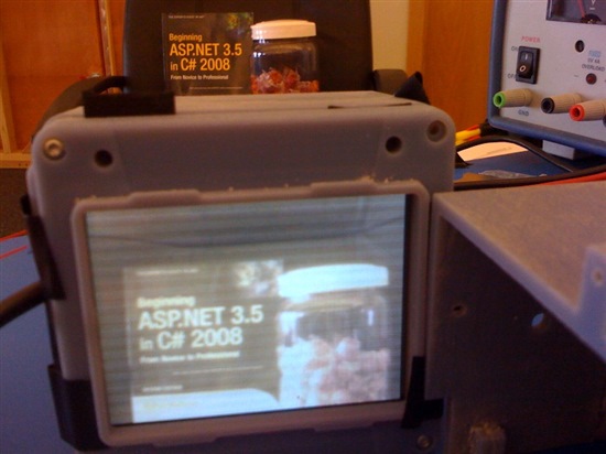

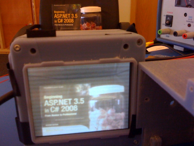

Second Question:
My output in the "working" case looks like there is "wavy" lines throughout.  I am more than willing to give you all my registers and give as much detail as I can about the sensor.  We had to sign a NDA for details, but basic info I believe I can share.
Question:
1) What registers/considerations should be looked at to try to fix the "overscanning"/"wavy" lines??  The picture below is a pretty good representation of what is happening.
Please see the picture attached:
  • Aside from IPNSRC = 0 you want to have CFG.CLKSEL = 1.  I do not believe we have any sample source code showing direct path from CCD to IPIPE (without using SDRAM), although the hardware is certainly capable of this.
    wavy lines could be due to very slight video timing problem; it can also be due to the way the pixel data is stored in DDR2 (some data may be lost, but less likely).  Finally, even less likely, this could be due to DDR2 bandwidth limitations (although this usually shows up as random white noise, not what you are seeing).  Are you enabling all video and OSD windows?  If so, you can try disabling one or more to see if the issue goes away; this will allow us to trouble-shoot a little deeper.
