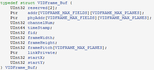

Is that feasible to dump the output of a NullSrc Link into a File?
   I am now using EVM8168 with DVRRDK 4.0.  I wonder if I could instantiate such a Link:
NullSrcLink -> ipcFramesOutLinkRTOS -> ipcFramesInLinkHLOS -> File
  Actually, I want to generate such a link to test the valibility of my write cbfxn and the NullSrcLink.  Successfully build my usecase, however, the M3VPSS core hang once I tried to run my usecase:
