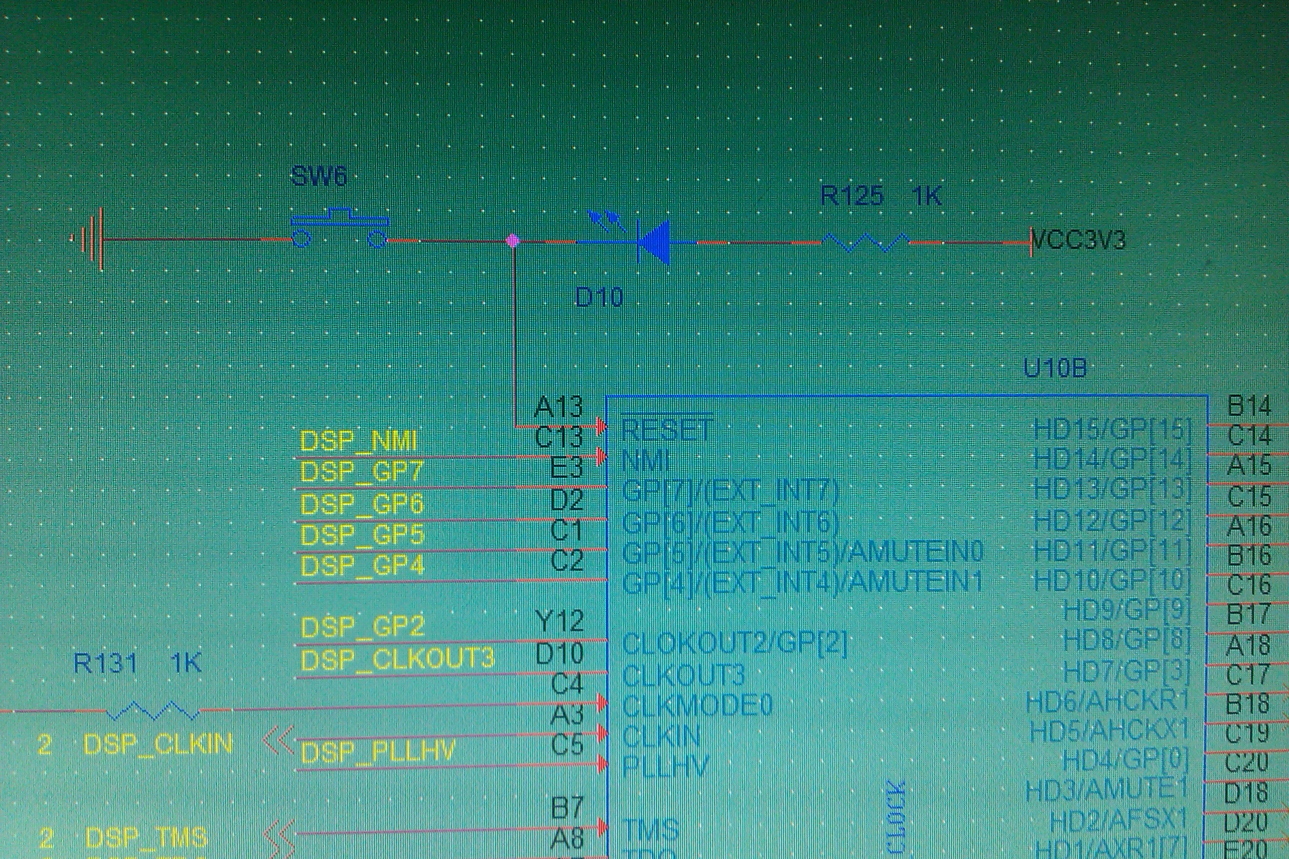

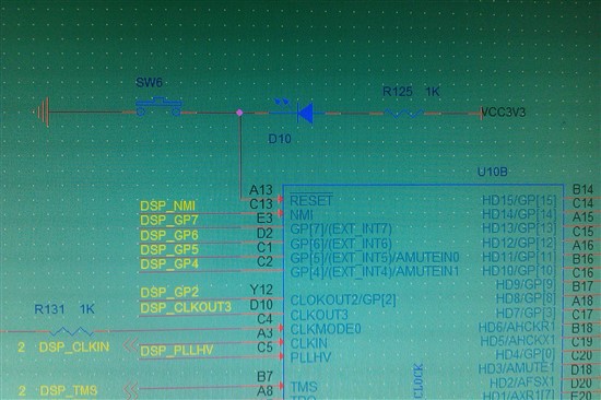

    Now, I think my reset circuit is defective. It generates reset signal only from a button. Reset pin remains high level when board powers on, and reset signal must be send manually.
    The above is my reset circuit, I took the picture by my cellphone, I am sorry for the inconvenience.

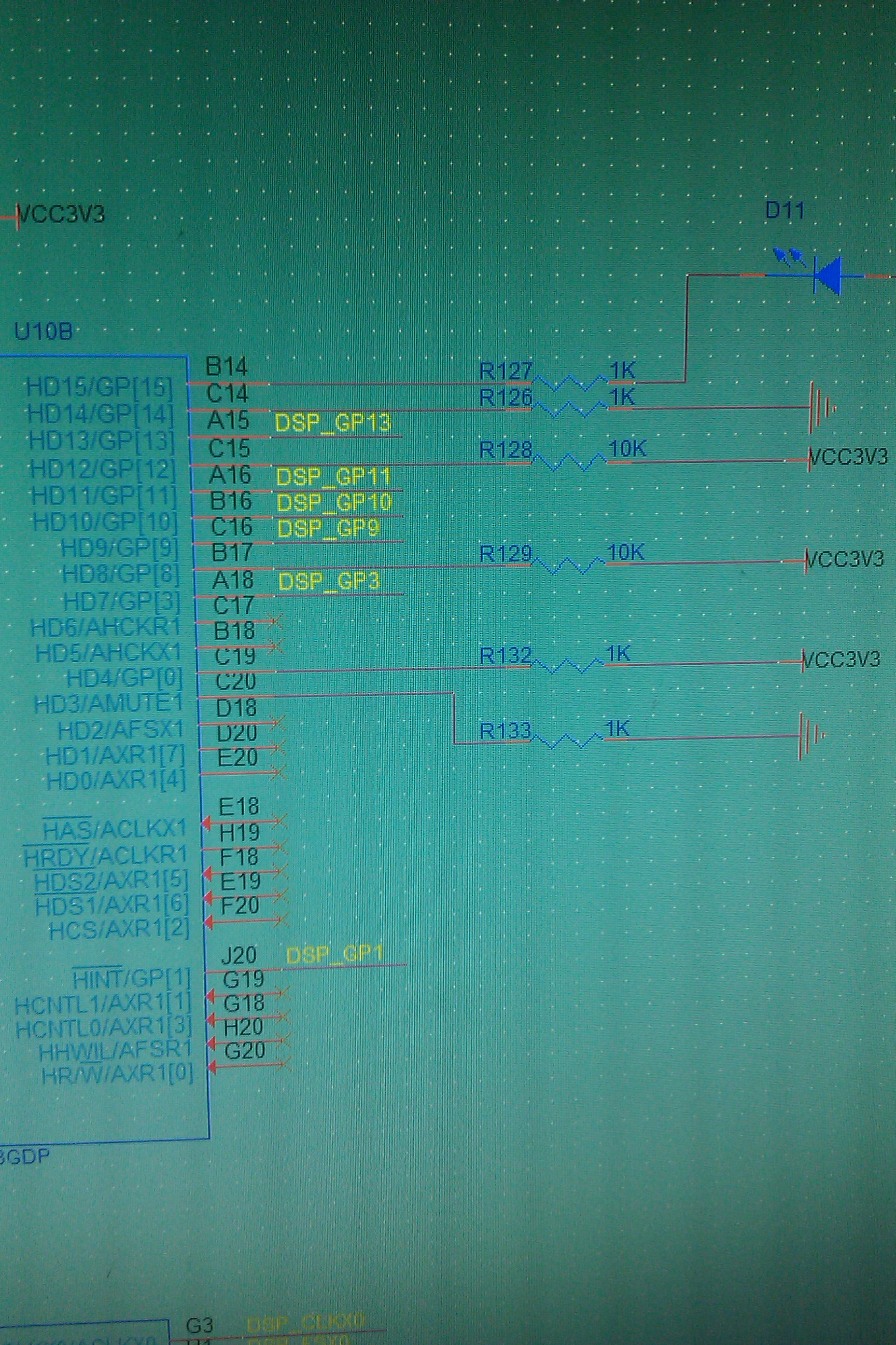

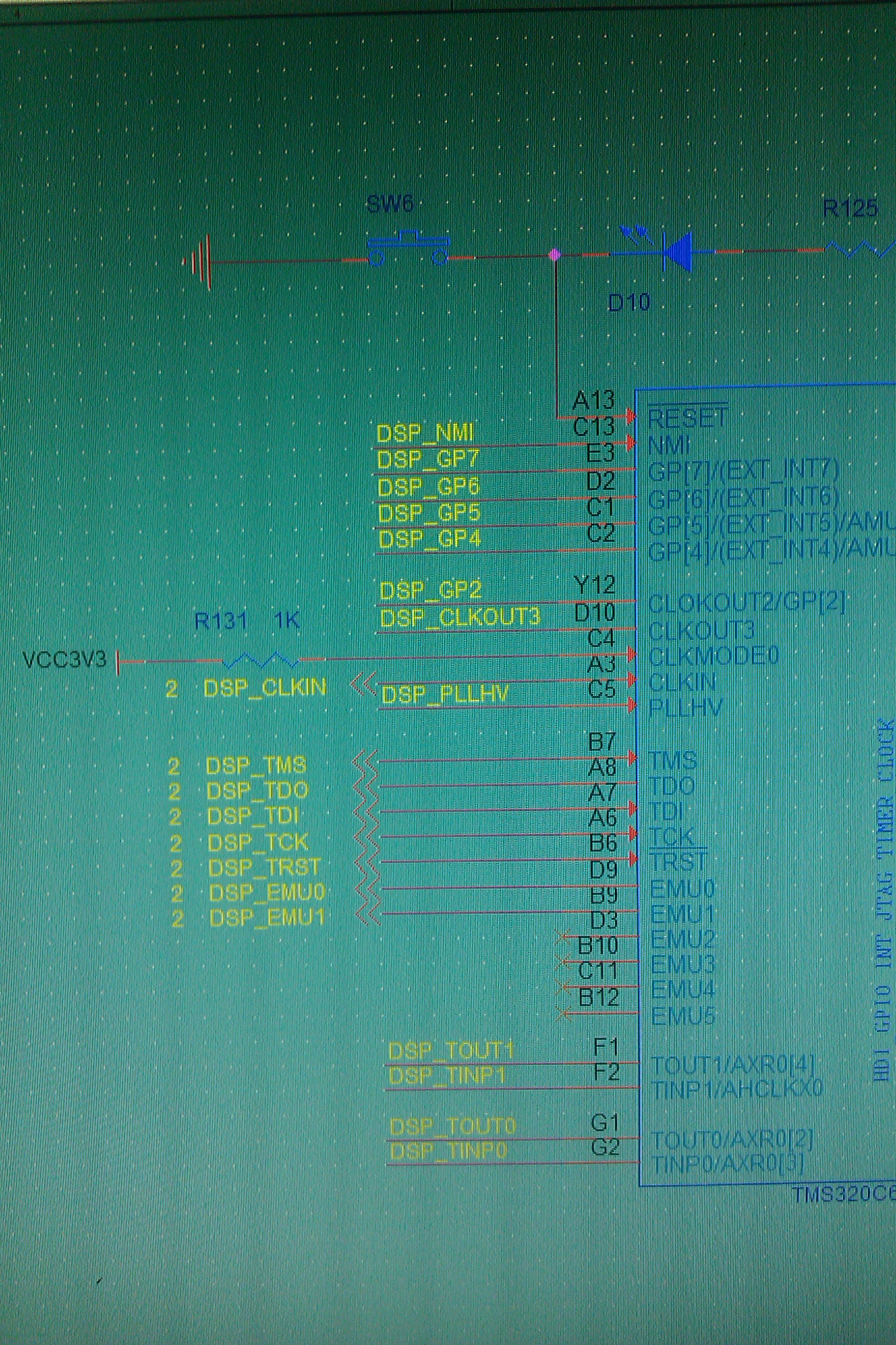

    The above two are the connection of configuration pins, Can you help me check them? Thank you!

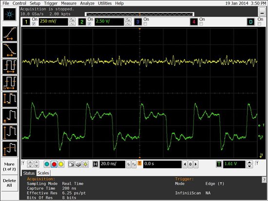

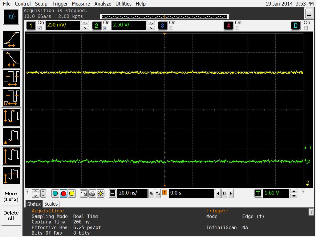

    My reset circuit can not work when board powers on. The output of clkout2 is unstable after power on and before reset.the yellow one is the signal on reset pin, and green one is the output of clkout2.
    the output of clkout2 is unstable.

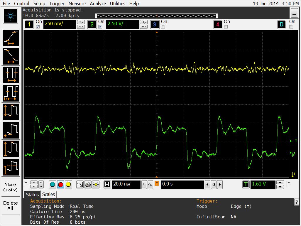

    After IC is reset by button, clkout2 remains low level. PLL of DSP may not work, so the whole IC has no clock internally. I think that befor reset the dsp IC is in uncertainty. Therefore output of PLL is unstable.

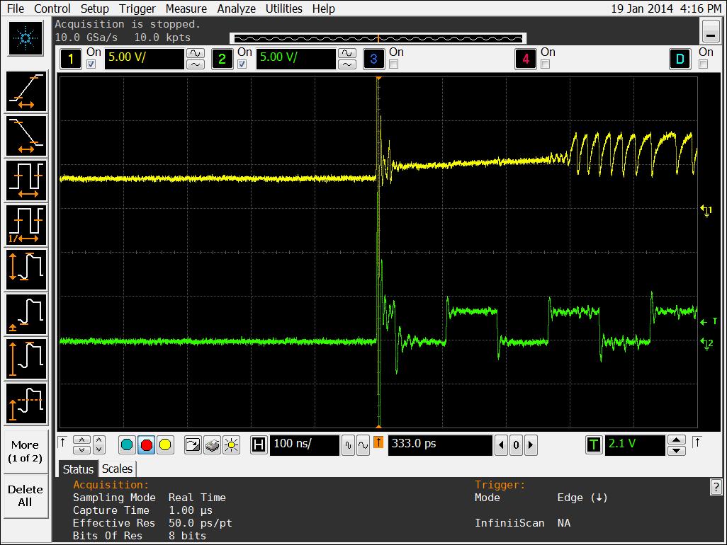

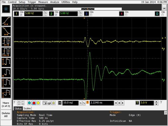

    the yellow one shows the signal on reset pin when I touch nearby ground, and green one is the output of clkout2. Before touching PLL has no output, and after that PLL works. Therefore, dsp IC works.

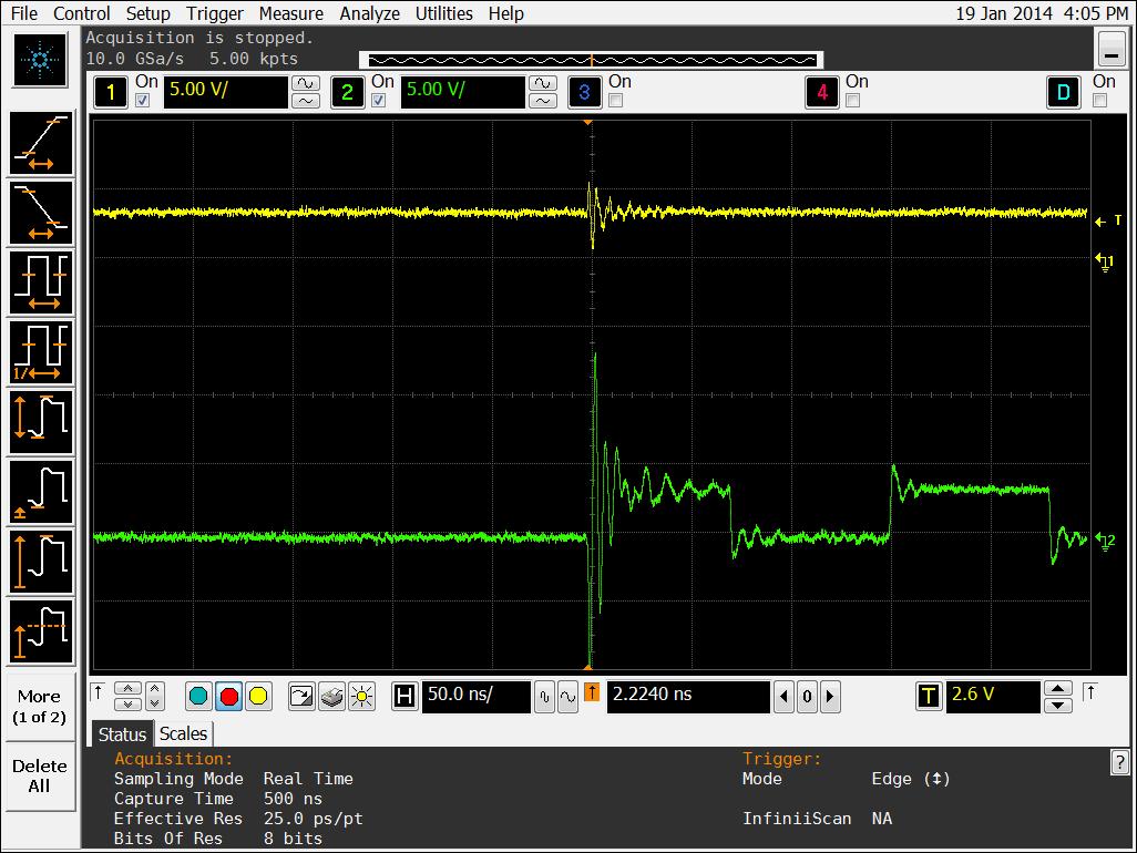

    This is the enlargement of signal actions when I touch nearby ground.

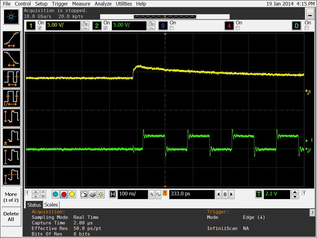

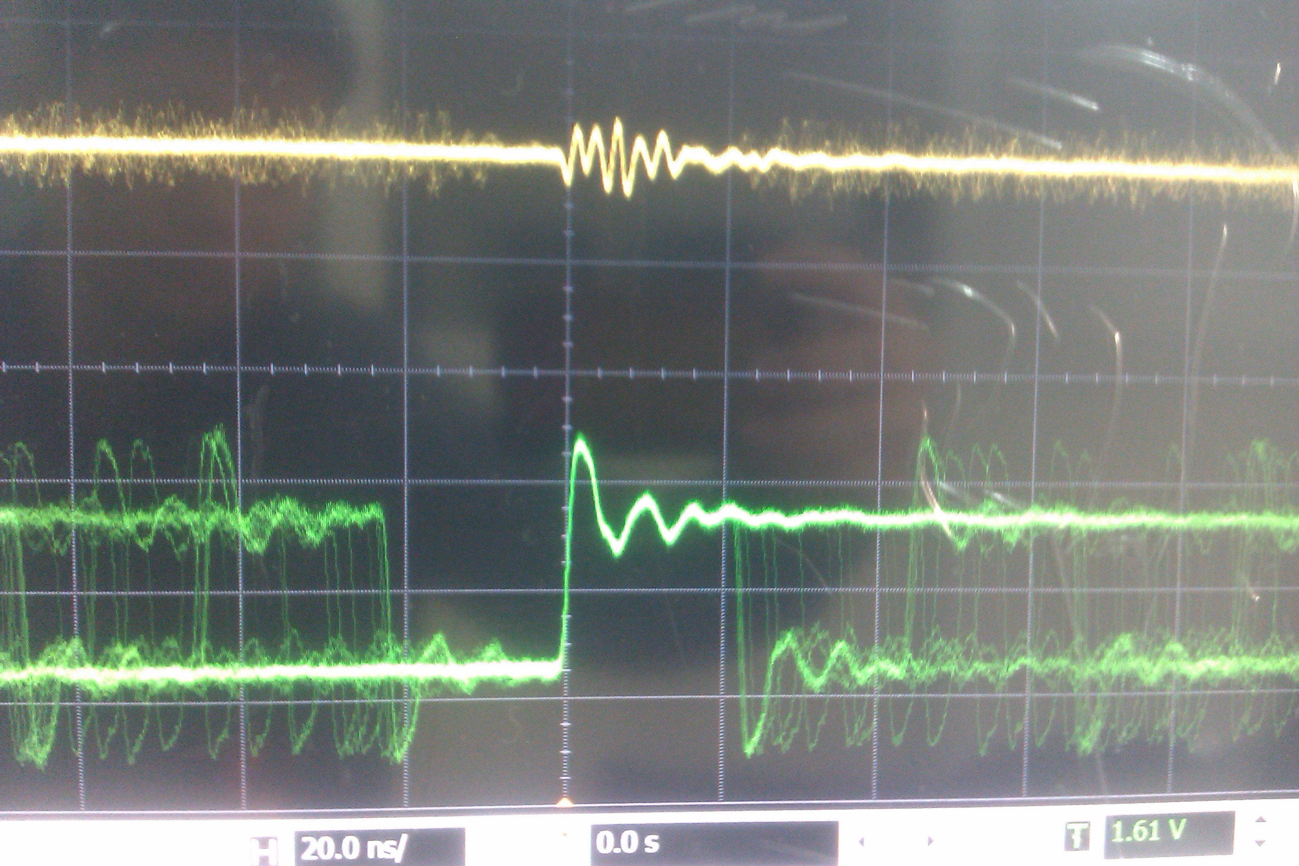

    the yellow one shows the signal on reset pin when I touch reset pin, and green one is the output of clkout2. The reset signal resulted is good, and PLL works.

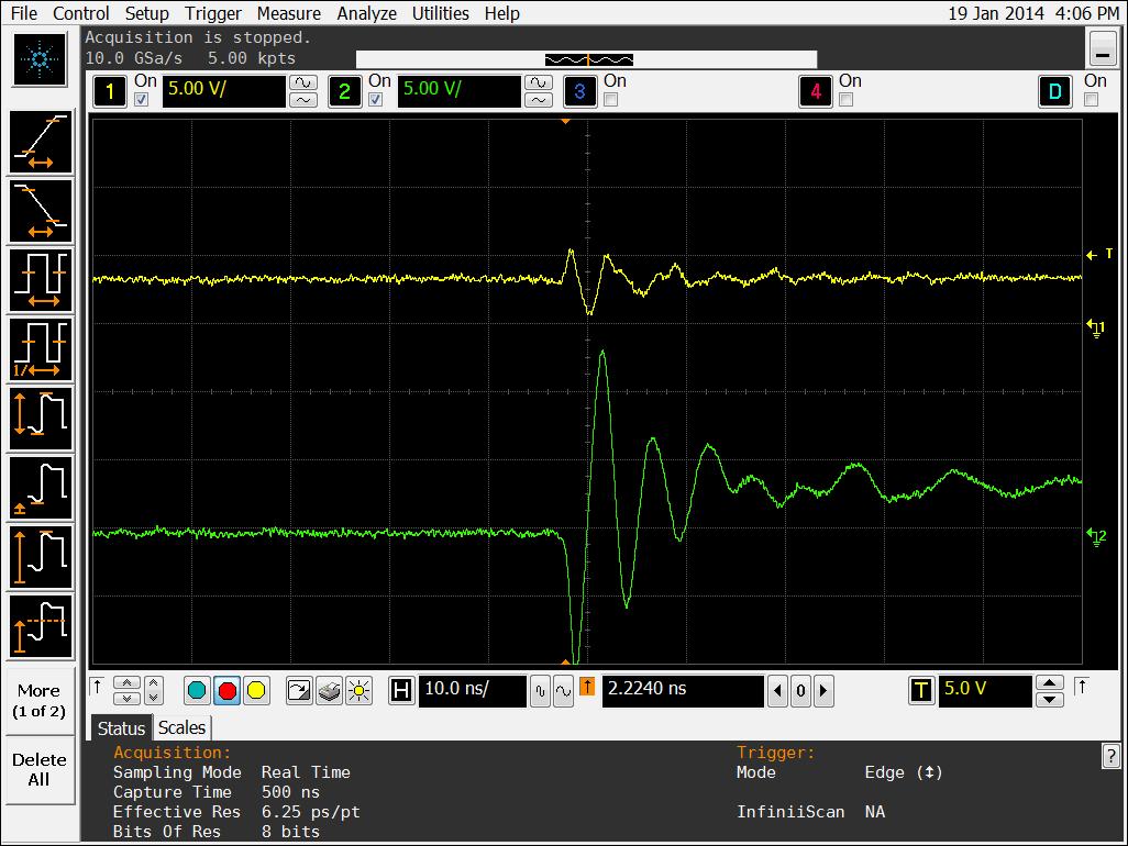

    In above picture, I touched the reset pin. The reset signal resulted was very bad, but it could reset dsp IC too. Then PLL worked, and the whole dsp IC worked. Can you explain it to me? Thank you!
    It is said that reset signal generated from button always has some glitches, but In above pictures reset signal resulted from touching has glitches too. however it works. can you tell me which conditions the reset signal needs to meet? or when I touched the reset pin which conditions were meet?
    I think I need a need a new reset circuit to reset IC when power on. I should use a reset IC from TI, and there should be lots of mature solutions for dsp reset. Can you give me an advice?

    You may find some helpful articles on the TI Wiki Pages that I referenced above. Also, the DSK6713 schematics would be a useful place to start. It is very difficult to have to start your design from nothing, so we offer examples like the DSK to help you along the way; it may not be a perfect reference design but it is a good, working board.
    It looks like you have some serious board issues other than just the lack of a Power-On-Reset. Some of the noise on your traces above could just be due to your measuring equipment, but a lot of it is showing serious signal integrity issues that must be dealt with to avoid problems with your board's operation.
    You may want to check TI.com to look for a POR device. This would have the POR logic and delay, plus monitoring for handing the power-off or brown-out situation.
