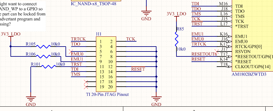

  • Something that isn't right is that I don't see RESETOUT (pin T17) go low when RESET (pin K14) is pulled low. RESETOUT is pulled high to 3.3V through a 10k resistor.
  • Hi George,
    You have tied both RESET and TRST to an external switch and held them low then high, but basically as per the documentation TRST only needs to be released when it is necessary to use a JTAG controller to debug the device or exercise the device's boundary scan functionality.
    TRST and RESET need to be asserted upon power up, only RESET needs to be released for the device to boot properly. TRST may be asserted indefinitely for normal operation, keeping the JTAG port interface and device's emulation logic in the reset state
    Normally we pull-down the TRST pin on board with 4.7k resistor
    Antony
  • Hi Antony:
    TRST is pulled low on the board through a 10k resistor. I will leave it low for my experiments.
    RESETOUT is pulled high to 3.3V through a 10k resistor and is only connected to the Reset input (pin 23) of the Ethernet PHY (DP83848HSQ/NOPB).
    I have not seen RESETOUT ever go low which seems to be telling me that something is wrong. Toggling RESET from low to high I see an increase of current from ~135mA to ~170mA with a 5V input to the board so something is happening. The only sign of life I can see now is the MMC/SD clock line go from low to high and that is not pulled high so the AM1802 is setting it high.

    If you don’t have the JTAG connector mounted on your board all you need to do is wire wrap between the JTAG connector and to your board
    The board design doesn't control RESET so will JTAG take care of that for me or will I still need to add an external switch to pull it low until after the board is powered up?
    Does your board have processor supervisory circuit that initiates RESET when you do Power ON?
    Please refer the JTAG pin definition
    http://processors.wiki.ti.com/index.php/XDS_Target_Connection_Guide#Target_Connection_Design
    Please refer the below wiki links to connect AM1802 target to CCS
    http://processors.wiki.ti.com/index.php/How_to_connect_to_the_OMAP-L138/C6748/AM1808_EVM_board_using_CCS%3F
    Antony

    No, unfortunately I forgot to tie RESET into the power up circuit so it is floating on the board. It is brought out to the JTAG header so currently that is where I have attached a pull down and switch. Attached is the schematic review that TI did before we did board layout and they also missed the floating RESET pin.
    Power is ramped up via a circuit using TPS650061 and based on your app note SLVA483 but I forgot to tie the AM1802 reset pin to the TPS650061 reset pin.

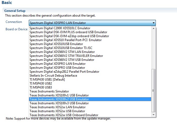

  • George,

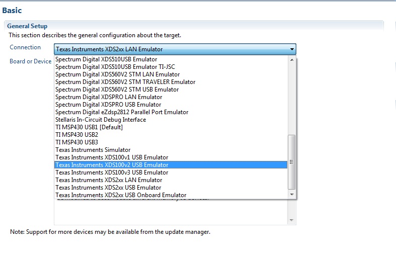

    The wiki link I have shred for CCS Target connection is same for CCS4 vs. CCS5
    You can select Texas instruments XDS100v2 emulator the USB100v2 is a TI XDS100v2-compatible emulator fully supported under CCS v4 and future Texas Instruments roadmap software development environments.
    Attached the screen shot for your reference

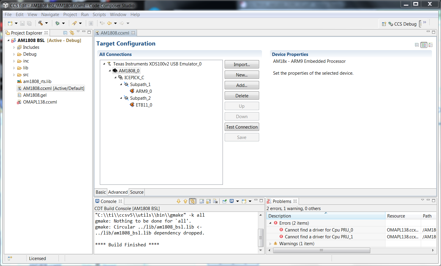

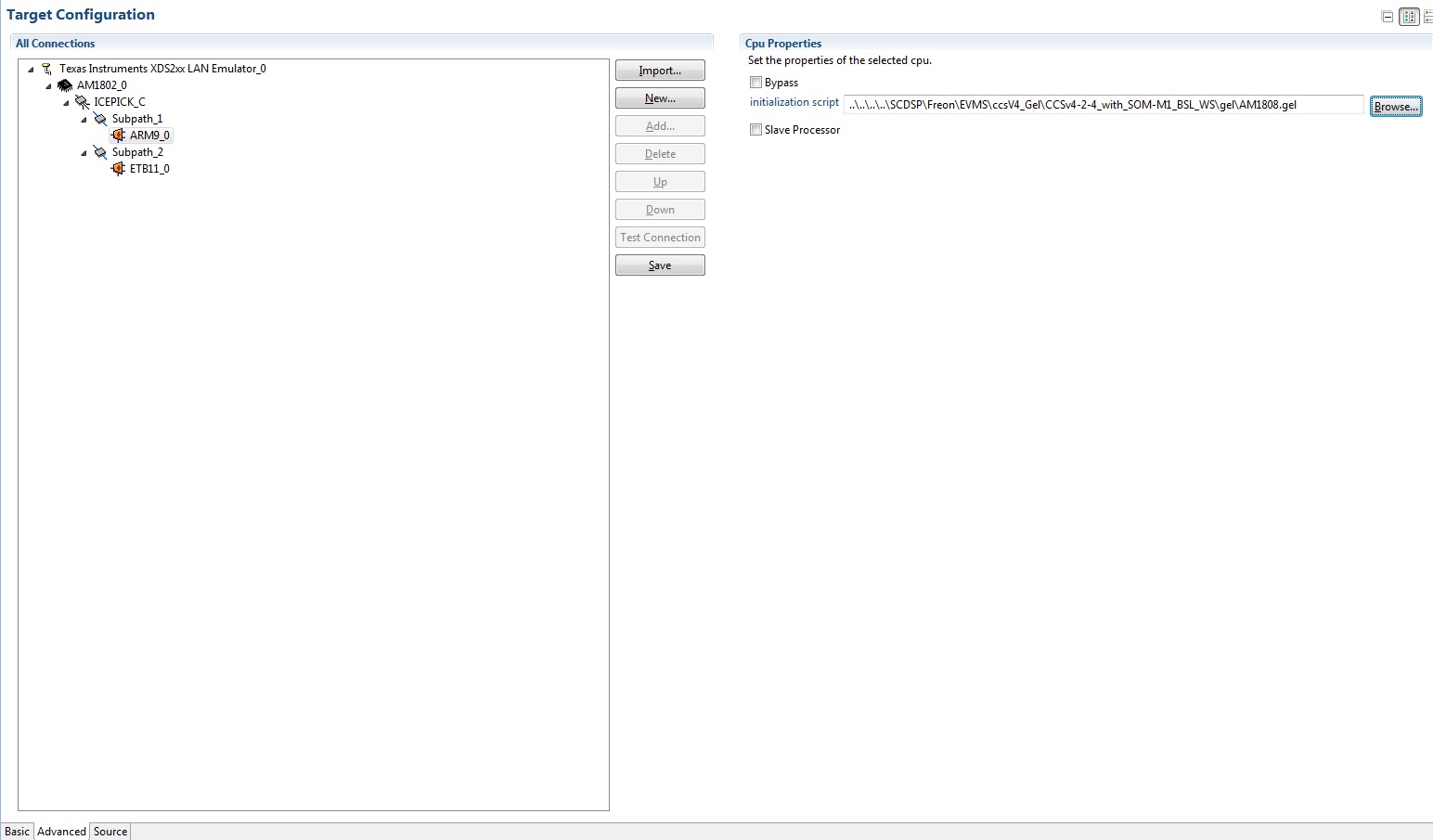

  • I made a little progress by double clicking on the ccxml file and that showed me the page with the Advanced settings.
    I don't think ICEPICK is supposed to be there is it?
  • George,
    ICEPICK should be there under the sub patch select ARM9 and  load the debug gel file in the initialization  script  path and save it.
    Before connecting the target you can check the JTAG connection by pressing the Test connection options.
    Once you succeed then connect the target by right clicking on the .ccxml  file and  select the launch selected configuration
    Antony

    OK, well I thought ICEPICK was a different hardware than my JTAG controller. When you say load the debug gel file, which file are you referring to? The download from LogicPD has 3,414 files in 1,036 folders. By process of elimination I'm thinking it's in one of these directories:
    ARM BSL
    OMAP-L138_GEL_BSL_Files
    gel
    But which one and which file? Does it matter that their eval kit is for the AM1808 and my board has a AM1802?

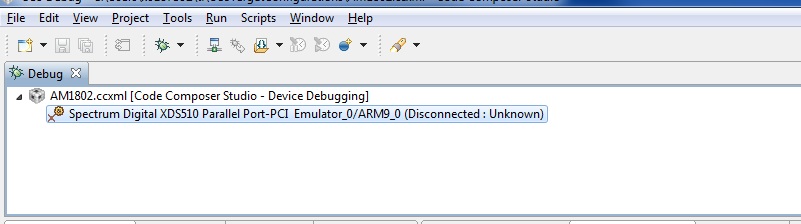

    I'm not sure I have the right file loaded but I have run the Test connection and it fails. The light on the JTAG board is ON and there is a XDSSerial command that reports that it sees the controller.
    I have run the tests with the controller connected to my board so I can try again without it connected. The errors are referencing something about FTDI drivers but Device Manager doesn't show any problems.
    George
  • I disconnected the JTAG Controller and ran TEST Connection and the software reports that I need to be connected to the target.
    See attached error information and a screen grab showing those error messages I mentioned last night
  • When I power up the board, select ARM9_0, and then click on the test connection button I get an error
    -----[An error has occurred and this utility has aborted]--------------------
    This error is generated by TI's USCIF driver or utilities.
    The value is '-154' (0xffffff66).
    The title is 'SC_ERR_FTDI_WRITE'.
    The explanation is:
    One of the FTDI driver functions used to
    write data returned bad status or an error.
    See attached file for full details of the test.

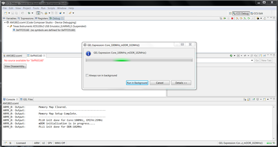

  • We finally made it past the JTAG issues and have successfully run the debug GEL tests. We also were able to run the UART test but have failed both the SD Card and RAM test. I'm not sure but I think the SD Card test might be using RAM for the FIFO so failing the SD Card test could be related to the RAM test failure.
    I have gone through the spreadsheet timings and came up with values of:
    DRPYC1R  0x000000C6
    SDCR:  0x00134A32
    SDTIMR1:  0x26522A09
    SDTIMR2:  0x3C14C722
    SDRCR:  0x00000492
    I edited the AM1808 initilization program with these changes and watched the registers as I stepped through the code. I can see the code step into my changes but I don't see the actual register values change. I'm not sure why this is happening.

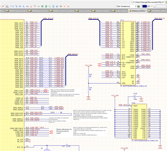

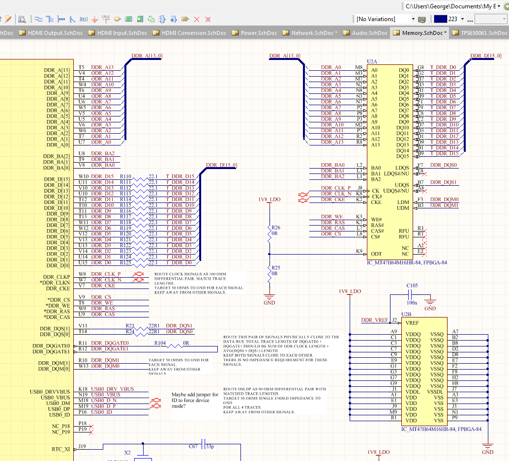

    The AM1808 SOM uses Mobile SDRAM (Micron MT46H64M16LFCK-6:A) according to the BOM but we are using DDR2, Micron MT47H64M16HR-25:H so I would expect the RAM test to fail if the registers are not configured properly.
    Attached is my worksheet for reference6175.GI-mDDR_DDR2_Memory_Controller_Register_Calc_Rev4.xlsx
    Is there another way to do a simple DDR test and/or SD test?

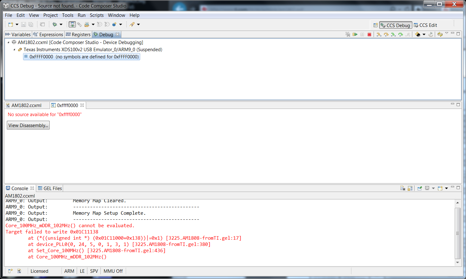

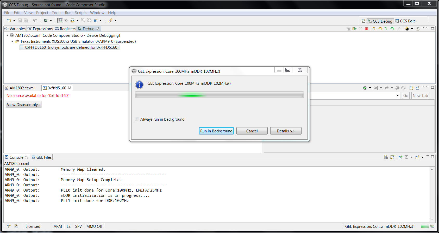

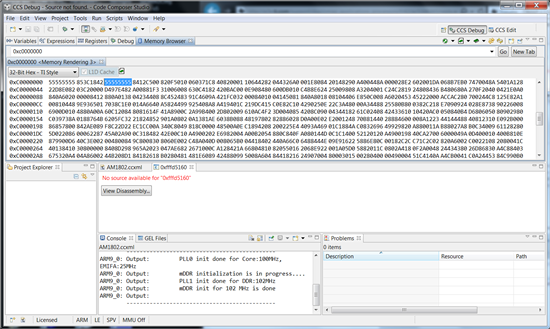

  • I played around this afternoon with it and for a few times I was actually able to bring up the memory view and change some values. I was confused why when I changed one location it seemed to change 2 locations. I closed the session and power cycled but now I just keep getting the error message that I posted.
    I think this has to do with how my project is set up and the steps I am taking. I've tried so many different things just to get to where I am now that nothing is clear as to what actually needs to be done. Now that I know a little more than I did last week can you provide a project that you would work with an AM1802 board and the steps I need to reliably reproduce this testing environment. I want to be able to confirm that DDR2, NAND, and the SD card are working. Our design follows the LogicPD with the exception of using the AM1802 processor and using DDR2 instead of mDDR. I would think that I could just change the gel script and use their test programs but as you know I'm not having much luck. I was hoping to just create a boot SD card and go from that but I'm not that lucky.
  • Hi George,
    According to the debug gel console output everything looks fine for me.
    However few times you’re able to bring up the memory view and afterwards it shows error message.
    Have you tried Core_100Mhz_mddr2_102MHz….?
    I don’t see there is much difference between DDR and LPDDR it should work with the same Gel script.
    Can you please try re-calculating the DDR timing values with the spreadsheet from the below wiki link
    http://processors.wiki.ti.com/index.php/File:SYS_CLK_CALC_OMAP-L138_C674X_AM18X_v1p0.zip
    Please check the DDR connection once (Schematics & Layout), power and clocking.
    Once the DDR is up we will able to test other interfaces quickly.

  • Hi Antony:
    Is your spreadsheet different than the one I attached a few posts ago?
    I don't think Ihave a hardware issue but I'm thinking that CCS is messed up. I've tried so many different things to get it working I'm not confident that it is configured correctly and I cannot find any clear instructions on what I can do to wipe everything out and start with a clean environment and try the latest tests again.
    I've gotten it to write to the memory once (or so I believe) so that should tell me that the board is designed properly. I've reviewed the design as well as TI so I'm really thinking this is all CCS issues.
    Can't you provide some simple steps to ensure that CCS is correctly configured for a board with a AM1802?

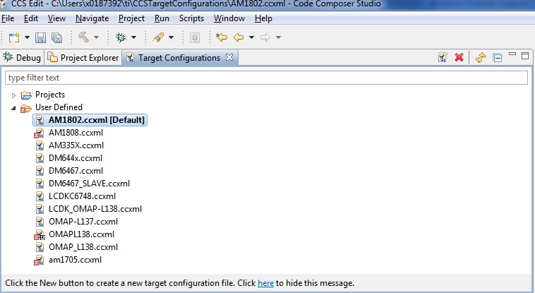

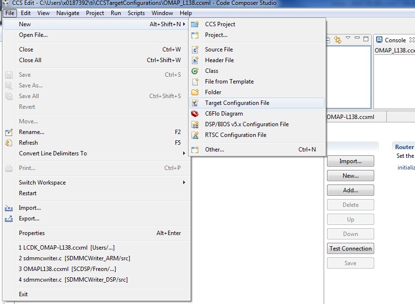

  • Hi George,
    Here is the steps

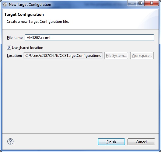

    1. Open the CCS and go to File-New- Target configuration File (Step1)
    2. Once the new target configuration window opens give the target name AM1802 and click finish button (Step2)
    3. In the basic option window select the right emulator you are using from  the drag down menu (Step3)
    4. Then select the device AM1802 once you done press the save button  (Step4)
    5. Then press advanced tab in the same below and select the ARM9 core and point the AM1808 initialization script in the right side of the window ,once you done press save button (Step5)
    6. You can go to view-target configuration file to view your target configuration visible it will display as AM1802.ccxml  (Step6)
    7. Right click the target configuration and select  set as default option ,then right click again and select launch target configuration  (Step7)
    8. Once you see the ARM9 target  in the Debug menu as disconnected, Right click on the target ARM9_0 and select connect target
    9. Then go to script menu and select the frequency options Core_100MHz…

  • Once I connect I see a window open up that says "No source available for "0xfffd5160"
    I ignore that error and proceed to set the frequency and I get the error I've been except for that 1 time it appeared to work
  • What doesn't make sense to me is that I'm able to read from the CPU using the debug gel scripts 100% of the time. I'm also able to run any of the other scripts as shown below. From my understanding the other scripts are writing to the CPU registers just like the set frequency is supposed to do yet the set frequency returns an error as though it's not able to access the DDR registers at 0x01C11138 and that seems to tell me that something is not configured correctly or my understanding of what the scripts are doing is incorrect.
    Is the memory map different between the AM1802 and the AM1808??
  • OK, I may have found the problem or I'm just lucky this time connecting to the target. I changed my JTAG to use adaptive frequency and this time it connected.
    If I enter 0xc0000000 in the Memory Browser and hit GO I do see values in memory. I moved to 0xc0000004 and changed it to 55555555 and hit enter but locations 0xc0000000 and 0xc0000008 are then changed to 55555555 and 0xc0000004 reverts back to the original value I believe.
  • Hi George,
    Can you redue the JTAG clock frequency and check once.
    Antony
  • So this behavior is not normal? I'll reduce the frequency down to maybe 100kHz and try again.
    I didn't go as low as 100kHz but I'm getting the same result I don't see anything wrong with the connection between the DDR2 and the AM1802:
  • I was reviewing the GEL file you provided and I believe that the RAM configuration is not compatible with the DDR2 I have on my board. As a quick test I was able to connect and using the memory browser I modified the SRAM successfully (0x80000000).
    I made the following changes to your GEL file but I get errors when it loads. I'm a little confused why there are 3 different memory enable registers (MSDRAMEN, DDR2EN, SDRAMEN). I would expect that to just be a single bit register with something like 0 for mDDR and 1 for DDR2 so since I don't understand the relationship between these register bits perhaps that where my error is. The TRM isn't much help as it just states that the enables DDR2, DDR, and SDRAM and they are used together?

  • The recommended method for getting the right EMIF values is to utilize this wiki page:
    http://processors.wiki.ti.com/index.php/Programming_mDDR/DDR2_EMIF_on_OMAP-L1x/C674x
    You should use the spreadsheet on that page in conjunction with the data manual for the specific DDR2 device that you put on your board.  You need to enter the clock speed to which you configured the PLLs as well as all the timing parameters from the DDR2 data manual in order to come up with the appropriate EMIF configuration.  You should make sure the values being programmed by the gel file agree with the values being generated by the spreadsheet.
    Details of how to program those fields is given in the TRM in Section 14.2.13 Auto-Initialization Sequence.
  • Yes, I've used that spreadsheet and attached it in an earlier post but earlier in this thread I was told "I don’t see there is much difference between DDR and LPDDR it should work with the same Gel script" so I didn't go through the GEL script and verify everything as I was told that it should work.
    According to my review of the Micron MT47H64M16HR-25:H datasheet and using the spreadsheet I come up with the following register values:
    SDCR 0x00134A32
    SDRCR 0x00000492
    SDTIMR1 0x26522A09
    SDTIMR2 0x3C14C722
    DRPYC1R 0x000000C6
    I'll review my GEL changes that I posted above compared to this and see if I missed something. I know my timings are different than what the GEL script currently uses but I don't think a timing value should cause the memory write changes I'm experiencing.

  • George,
    Recently you’re able to bring up the memory browser window and changed some values in the DDR memory location but other location gets changed instead of intended location.
    Now again you’re facing the target connect issue when you do the frequency settings in the gel script, I hope you’ve already resolved this issue by using adaptive frequency in JTAG connection …?
    Please check the similar kind of post for the DDR2 configuration.
    http://e2e.ti.com/support/dsp/omap_applications_processors/f/42/t/116609.aspx
    This customer resolved the issue by changing the RL value in the DDR PHY control register
    The Read Latency (RL) needs to be greater than CL by ateast 1.
    The datasheet suggests a min RL = CL+1 and a max RL =7.
    Configuring RL to 7 has resolved this issue
    Please cross check with your settings, but make sure the timing values are aligned with respect to your memory datasheet
    Antony
