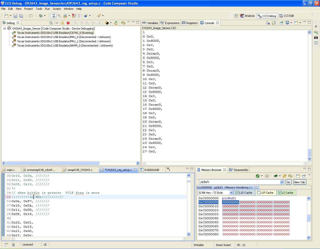

I have set data section to DDR2 ( 0xC0000000 - 0xCFFFFFFF ) to store the data acquired VPIF DMA0 and VPIF DMA1 .
In the Memory Browser tool of CCS doesn't show the data, but prints 4 values repetitively when programmed to print.

    OMAPL138 has a Memory Protection unit(MPU) that can be configured to manage access to memory from system masters. The MPU can record a detected fault, or invalid access, and notify the system through an interrupt. There are two MPUs on the device (MPU1 and MPU2). MPU1 is used to protect/manage access to shared ram while MPU2 is used to manage access to DDR2/mDDR. Please refer to chapter 6 in Technical reference guide for more information.
    You might also be interested in looking at the sample code (C6748_mpuTest.zip) we have distributed on this forum thread below that demonstrates this functionality using MPU2:
    http://e2e.ti.com/support/dsp/omap_applications_processors/f/42/t/158135.aspx
    Also, there is some MPU test project in the below E2E thread which prevents the DSP from accessing external DDR memory that is being used by the ARM:
    http://e2e.ti.com/support/dsp/omap_applications_processors/f/42/t/291838.aspx
