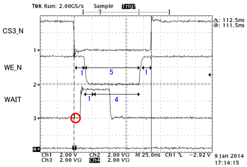

AM1808 Asynchronous Memory Operation with Extended Wait Mode
The minimum timing requirement for EM_WAIT pulse duration is 2 EMA_CLK period.
When EM_WAIT is less than 2 EMA_CLK period, may the Extended Wait be performed?
Our customer traced the Asynchronous Memory Write Timing with Extended Wait Mode. It as follows:
 EMA_CLK clock frequency: 62.5MHz (16nsec)
 CE3CFG.W_SETUP:1 EMA_CLK period
 CE3CFG.W_STROBE:4 EMA_CLK period
 CE3CFG.W_HOLD:1 EMA_CLK period
 AWCC.CS3_WAIT:01b (EMA_WAIT[1] pin is used)
 AWCC.WP1: 0b (EMA_WAIT[1] pin is low)
 AWCC.MAX_EXT_WAIT: 80h
The strobe period is expanded to 5 EMA_CLK period. While EMA_CS3 is asserted, the duration of asserted EM_WAIT is less than 2 EMA_CLK period.

  • Hi Daisuke,
    Out of three signals you have mentioned (CS3_N, WE_N, and WAIT), which signal the customer used as a triggering source to capture this waveform.
    It looks like the WAIT signal asserted before the CS3_N asserts.
    The external device assert EMA_WAIT signal that should not be asserted before the CS3 signal
    Which device they are hooked up on this peripheral?

  • Hi Antony,
    Thank you for your reply.
    EMIFA is connected to FPGA with the Asynchronous memory interface.
    I suggested to our customer modifying FPGA.
