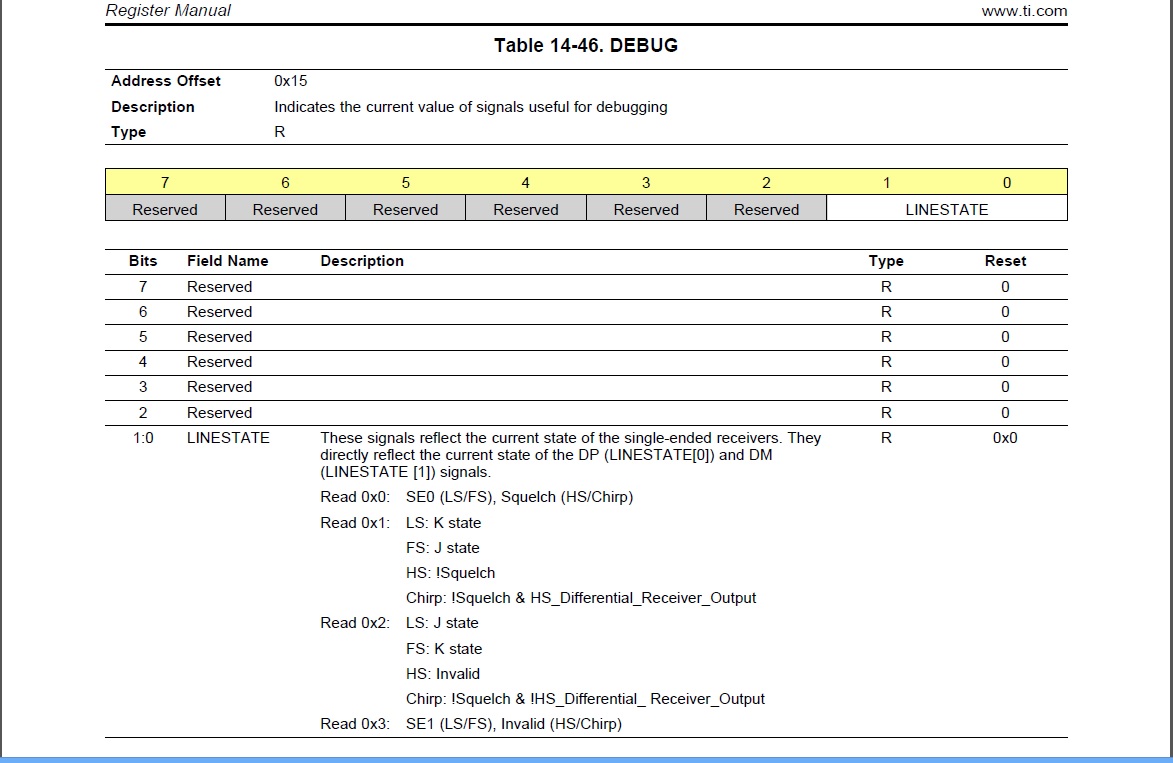

    One more thing i analysed with this issue.
    When HS and FS device failed during boot,i found the DEGUG regigter value is 0x11(0001 0001).
    But the same register holds the value of 0x10(0001 0000) during working condition(For LS devices). So my question what does these least two significant bits means?
     i am not able to under stand from the data sheet since it seems more hardware specific.
    Also i found one more register which is conflicts between Not working HS device and Working LS speed device.
    ie.OTHER_INT_STS register.It holds value of 82H(1000 0010)when booted working LS device and holds value of 22H (0010 0010) when booted with HS device.
    what does the 5th bit indicates here?
    Any updates on this please?
  • I am not sure what document you referred about those two registers. I am not aware of it. But from the doc screenshot you posted, DEBUG[1:0] is the state of DP/DM lines, which changes most of the time. So I would think those two bits are not related to the babble issue.
