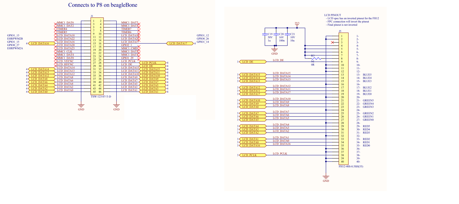

In the AM335x silicon errata (http://www.ti.com/lit/er/sprz360f/sprz360f.pdf), the 16 bit mode LCD is RGB and in 24 bit mode the LCD is BGR. Is it correct ?
I adapted board-am335xevm.c to support my new screen (I'm using beaglebone black with custom CAPE) and the red and blue colors are swapped.
Here's what I added in the board specific file:

Our custom CAPE is routed as stated in the errata..
Am I missing something ?
