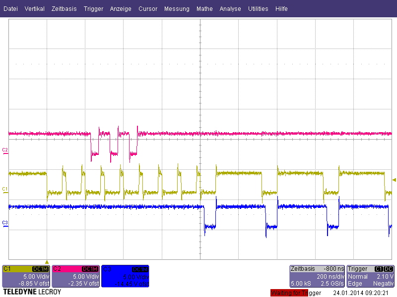

  • Hi Biser,
    Attached I have two scope screenshots. One shows the Chip Select signal (channel C1, yellow) how it should be. First you can see the three write accesses with the WEn signal on channel C2 (red). The 4 following accesses are read access with OEn (Output Enable) signal on channel C3 (blue). This is how it should be. But I can only do this unsing the "DMB" instruction.

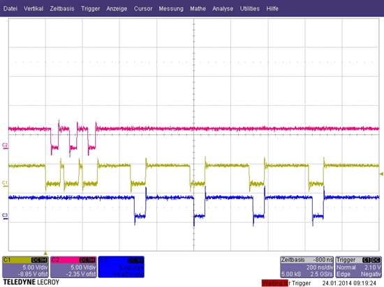

    The scond scope screenshot shows the write access without the "DMB" instructions. It clearly shows that the chip select signal goes low without a WEn or OEn signal activ.
    Can you please explain why the Chip Select signal goes low five times more than it should?
