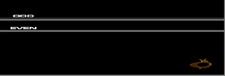

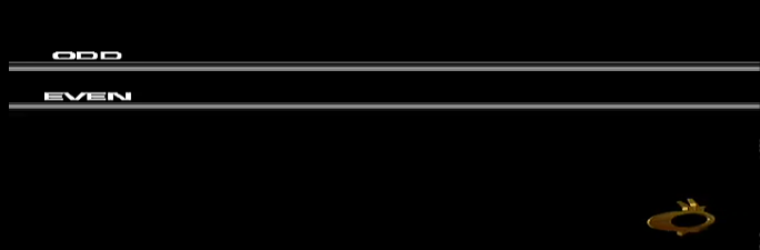

I am experiencing an issue with field at a time capture of NTSC video being passed through the scaler on the RDK.  The scaler seems to distort the 720x240 fields even though it is set up to scale 720x240->720x240.  I also have the scaling coefficients set to 1/1.

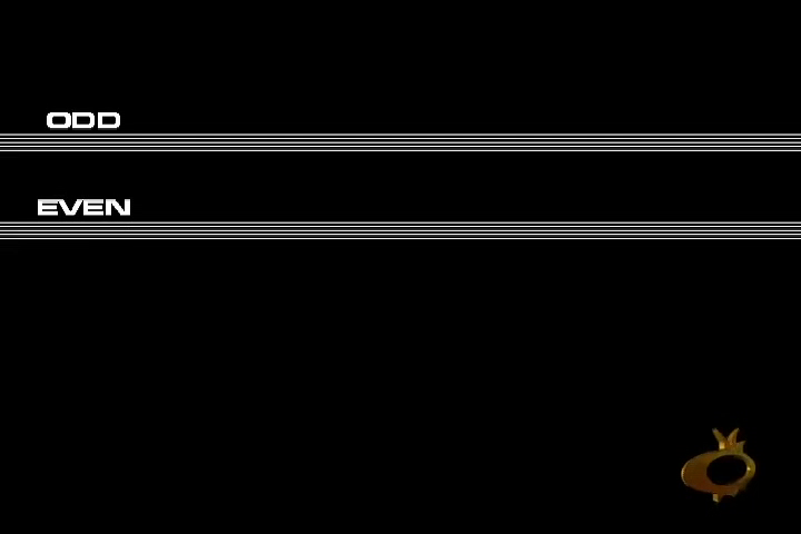

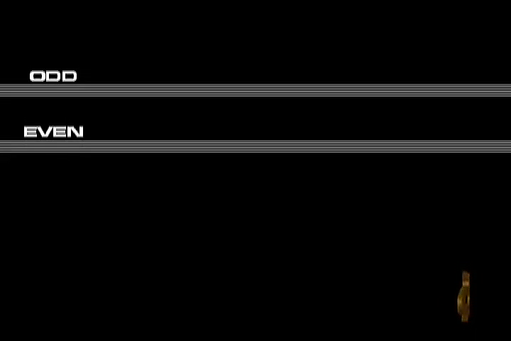

Here is the VLC output with the scaler in the path:
Here is the vlc output with the scaler removed:
This is the a frame from the captureLink:
This is a frame from after the passing through the scaler:
As you can see the scaler is really distorting the image even though no scaling is being done.  Is this do to the 720x240 frame size?  Should I be setting  up custom scaler coefficents to accomplish this?
  • I guess this issue have nothing to do with frame size. You should try set custom scaler coefficients.
  • Are you using scaler link or DEI link with DEI in bypass mode. What is the scaler id used. Does it quality look good if you use scaler link but set pChObj->scCfg.bypass = TRUE;
  • I am using the scaler link with the pathId = SCLR_LINK_SC5 (VPS_M2M_INST_SEC0_SC5_WB2).  Setting pChObj->scCfg.bypass = TRUE in SclrLink_drvCreateChObj() did not fix the issue, which really me since removing the scaler link fixes the issue.  I have found changing out the preset scaling Coeffs can make things slightly better or slightly worse.
  • If you set bypass to TRUE scaler link is essentially doing memcpy so modifying coefficients will  have no effect.

  • Can you try replacing Scaler link by DEI_HQ link and set deiForceBypass = TRUE and interlacedBypass = TRUE and set pChObj->scCfg[outId].bypass = TRUE in deiLink_drv.c and check if you still see the issue
  • Hi Badri,
          Have you found why the Scaler cause the distortion? I have the same problem but while passing 1080i through the Scaler,
    -David
  • We have confirmed the scaler register settings match the functional spec for interlaced in -> interlaced out scaling.
    We are presently looking at the scaler coefficients to check if they are correct for interlaced scaling.
    Note that the issue reported in the original thread seems to be some other issue related to customization done to base DVRRDK.
    We DONT SEE ANY ISSUE is scaler is set to bypass which is different from what is observed here.
  • Pls check if attached patch resolves the interlaced scaling artifacts issue.
    HDVPSS driver patch
    diff --git a/packages/ti/psp/vps/hal/src/vpshal_sc.c b/packages/ti/psp/vps/hal/src/vpshal_sc.c
    index ed01aaf..7317ff3 100755
    --- a/packages/ti/psp/vps/hal/src/vpshal_sc.c
    +++ b/packages/ti/psp/vps/hal/src/vpshal_sc.c
    @@ -41,7 +41,9 @@
     #define SC_MIN_REQ_WIDTH            (34u)
     #define SC_MIN_REQ_HEIGHT           (8u)
    +/* progressive mode only used for interlaced case also. So macro
    +   SC_INTERLACE_MODE is always disabled  */
    +/*#define SC_INTERLACE_MODE*/
