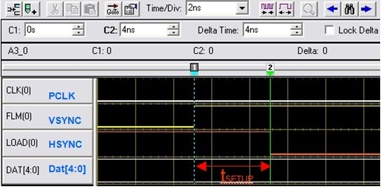

  • hi,biser,
           I check the  the palette buffer again and I think it's ok.
          I think maybe the hsync signal and vsync signal timing are not match the lcd requirement.
    tsetup = 4ns (Can’t meet STN Spec. tsetup>100ns)
    How to change the hsync and vsync timing to be consistent with LCD's spec?

  • hi,biser,
        We also have no the datasheet on hand.And we only have the timing chart of the LCD.
        The following chart is the STN timing of another CPU LCD controller.
    the VFRAME is the VSYNC signal,and the VLINE is the HSYNC signal.The WDLY is what we want.How to add the delay time from the last hsync falling edge to the vsync rising edge?
    we think the STN LCD maybe shifted the last line data to the first line of the next frame because the last hsync falling edge and the vsync rising edge are nearly generated at the same time in AM335X.
  • These are the horisontal front anf back porch times (HFP and HBP). Looks like they have to be equal in your case. Register RASTER_TIMING_0 holds the lower 8 bits (bits 7-0) of these times (Bits 31-24 for HBP and bits 23-16 for HFP). Register RASTER_TIMING_2 holds the higher 2 bits (bits 9-8) of these times (Bits 5-4 for HBP and bits 1-0 for HFP). The total 10-bit value (from 1 to 1024) specifies:
    For HBP: the number of pixel clock periods to add to the beginning of a line transmission before the first set of pixels is output to the display (programmed value plus 1).
    For HFP: the number of pixel clock periods to add to the end of a line transmission before line clock is asserted (programmed value plus 1).
