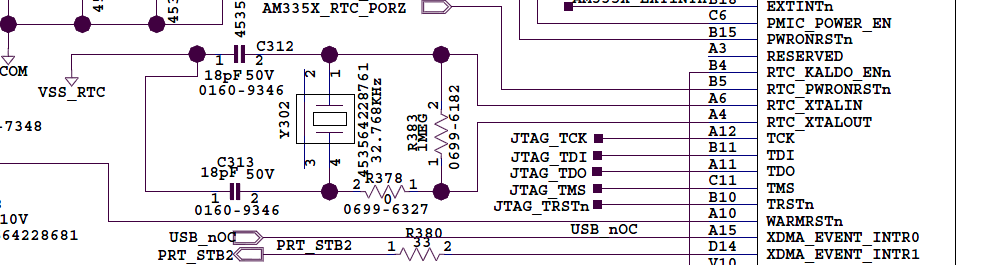

We are working on the AM335X RTC. We can use the AM335X internal32.768KHz  clock source to clock RTC, but when the system is powered off, we find the internal clock souce doesn't drive the RTC.
So we try to use the external 32,768 cyrstall as the source to the AM335X RTC click input, But the crystal cannot oscillate and RTC cannot start.
The following is RTC registers value. And the RTC external cyrstal circuit is attached too,
Please help to see if anything wrong in our design or the regisers setting.

  • The oscillator can be enabled or disabled by using the OSC32K_GZ bit of the RTC_OSC_REG register and the source of the 32-KHz clock is selected using the SEL_32KCLK_SRC bit of the RTC_OSC_REG register.
    I'm not sure what the EN_32KCLK bit of the RTC_OSC_REG register controls.  So I will try to determine its purpose tomorrow and let you know if it needs to be set high.
    The register values you provided seem to indicate you have the oscillator enabled but not selected as the source.  You also have the internal feedback resistor enabled and you have an external feedback resistor shown in your schematic.  You should remove R383 or disable the internal feedback resistor.
    Have you confirmed the oscillator is not oscillating using a high impedance scope probe or assume it is not oscillating because your RTC is not working as expected?  The oscillator may not operate properly if you connect a low impedance scope probe, less than 1M ohm, to the crystal circuit.
    I also encourage you to read Advisory 1.0.30 in the AM335x Silicon Errata.
    Paul

  • Hi, Paul,
    We found that when selecting external 32K crystal and enabling internal feedback, we have to remove the external 1M resistor to make the RTC working.
    But if we set to use external 32K crystal and enable external feedback, no matter the external 1M resistor is removed or not, the RTC can't oscillate. Is possible that 1M resistor value is not suitable?
  • In my last post, I recommended you remove the external resistor and use the internal resistor.
    Is there a reason you are trying to use an external resistor?
    I will send the oscillator designer an email and ask them to confirm the expected external resistor value.
    We would like to review the crystal data sheet.  Can you point me to it by sending the URL?
    Paul

  • The crystal they are using requires a load capacitance of 12.5pf.
    The total load capacitance is CL = [(C312*C313)/(C312+C313)] + Cshunt, where Cshunt is the crystal shunt capacitance (C0) specified by the crystal manufacturer plus any mutual capacitance (Cpkg + CPCB) seen across the AM335x RTC_XTALIN and RTC_XTALOUT signals.
    The crystal data sheet does not specify Cshunt, but this should be verified because this oscillator expect a crystal with Cshunt less than 1.5pf.  I'm not expecting the Cshunt of the crystal to be greater than 1.5pf.  However, if so they should select another crystal with a lower Cshunt.
    If we assume Cshunt of the crystal is 0.5pf, a PCB shunt capacitance of 0.5pf, with the AM335x shunt capacitance being less than 0.2pf, the 18pf values used for capacitors C312 and C313 would give a total load capacitance of 10.2pf.  This is less than the load capacitance of 12.5pf specified by the crystal.
    They should determine the actual Cshunt of the crystal then size the external load capacitors such the total load capacitance is 12.5pf.
    Paul
  • Hi, Paul,
    I changed the external load resistgor to 25pF, now the crystal can oscillate.
