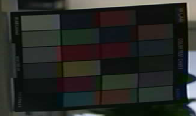

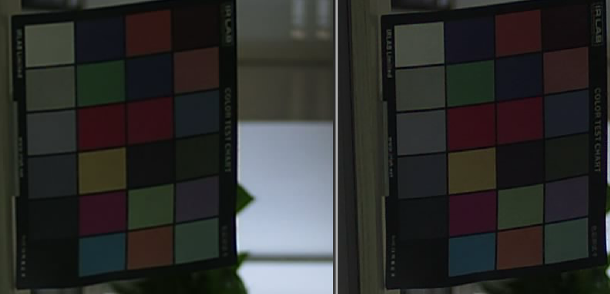

    Now, I have realized the image rotation(image resolution1080P or more than 1080P), however there is a flaw on the image left.
    My link as follow:
    capture --> dup(output:4) --> merge(in:4) --> dei --> dei --> framesout ...
    the original image as follow:
    the rotated image as follow:
  • Is the OSD on the original video (Date/Time/IPAddr) applied by SWOSD or part of original video from camera.It looks like applied by SWOSD since it is not present in rotated image. Try disabling SWOSD and check.
    If you are doing EDMA copy ensure pitch doesn't exceed 32767 anywhere and ensure you always use Natural view for all EDMA transfers.

    I have a question about the rotated image.
    When I rotated the image, I found the UV-component is don't match with the Y-component .
    The image as follow:
    And I correction the UV-component, however, the iamge is vague, as follow:
    Could you give me some advices?
    My link as follow:
    Capture->Dei(non-tiler to tiler)->Dei(rotation and tiler to non-tiler) ->...
    And the image width is different width the pitch, the width is 1600, and the pitch is 1664, when rotated, the image width is 1184 and the pitch is 1280.
