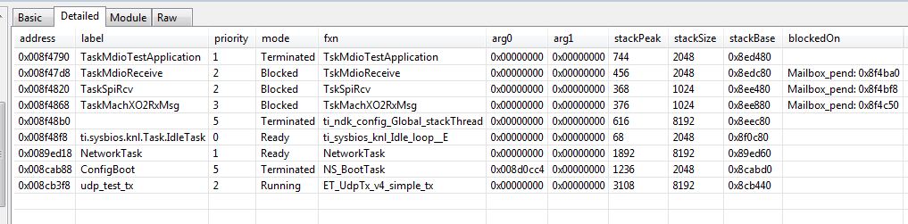

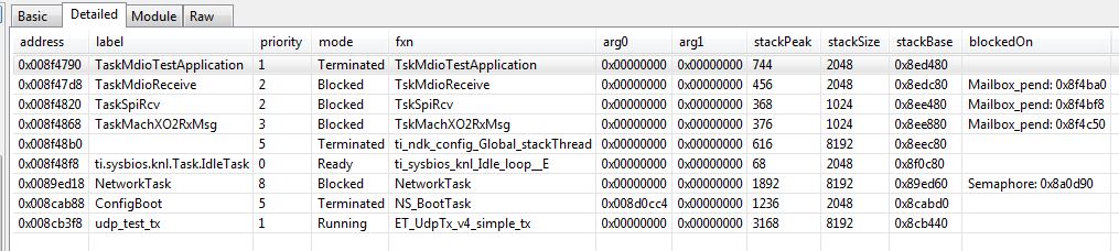

  • >> A few things to check:
    >> 1.  What Tasks are in your system and what are their priorities relative to each other?  A ROV screen shot when >> >> the failure occurs would be nice!
    >> 2.  Make sure the dummy for-loop does not get optimized out.  You can do this by having a function call in the >> >> for-loop or a volatile variable.  Basically, make sure that you are actually spending some cycles spinning.
    I do have code in the for loop so it's not optimized out. I also have a printf statement after each message is sent so I can see the delay loop is taking effect.
    I've attached the ROV screenshots in both the working case (TxDataTask is priority 1) and not working (TxDataTask is priority 2). I can see that the NetworkTask priority has dropped to 1. Does the task normally change priorities on the fly like that?
