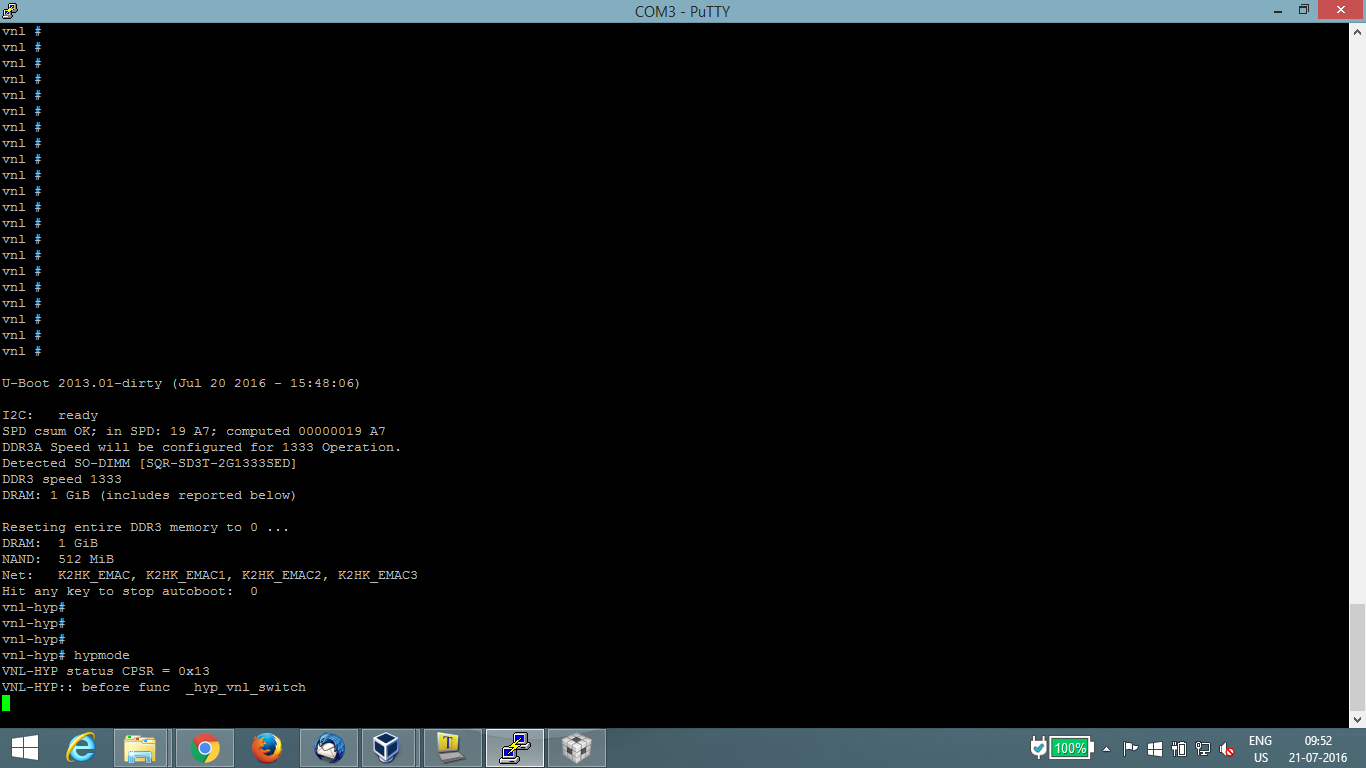

    I want to switch the  keystone EVM into hyp mode  it seems it stuck while changing the mode.
    Diff and Screen short is listed below::
    Diff::

    Screen short ::
    Arun
  • Hi, Rex,
    I want to switch the  keystone EVM into hyp mode,  it seems it stuck while changing the mode.
    It stuck into this piece of code  here i am swiching the mode into hyp mode ...

    Screen short ::
    Arun
