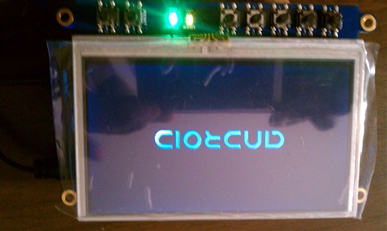

I am trying to boot Android on to a Beaglebone Black system.
Hardware:
  • Beaglebond black Rev A5C with Angstrom loaded
  • 4D system resistive touch LCD cape (4DCAPE-43T)
  • 5V power supply
  • USB connected to Host PC (Ubuntu 12.04 LTS)
Software
  • Beaglebone black has the stock Angstrom Linux
  • uSD card has JB 4.2.2, I have built the kernel
Connections
  • 5V power supply
  • mini-USB connected to Host PC (Ubuntu 12.04 LTS)
On boot/power up I held the S2 (uSD boot) button and release the button.
I was expecting the system boot from the uSD card with Android.
I don't see any of the USERx LED's illuminated.
Do I need to make change to the display resolutions?
What am I doing wrong?
Any suggestions?
Attach few pictures for the hardware too.
I have read the following post too.
I have ordered the Serial to USB cable will post the log file ASAP
