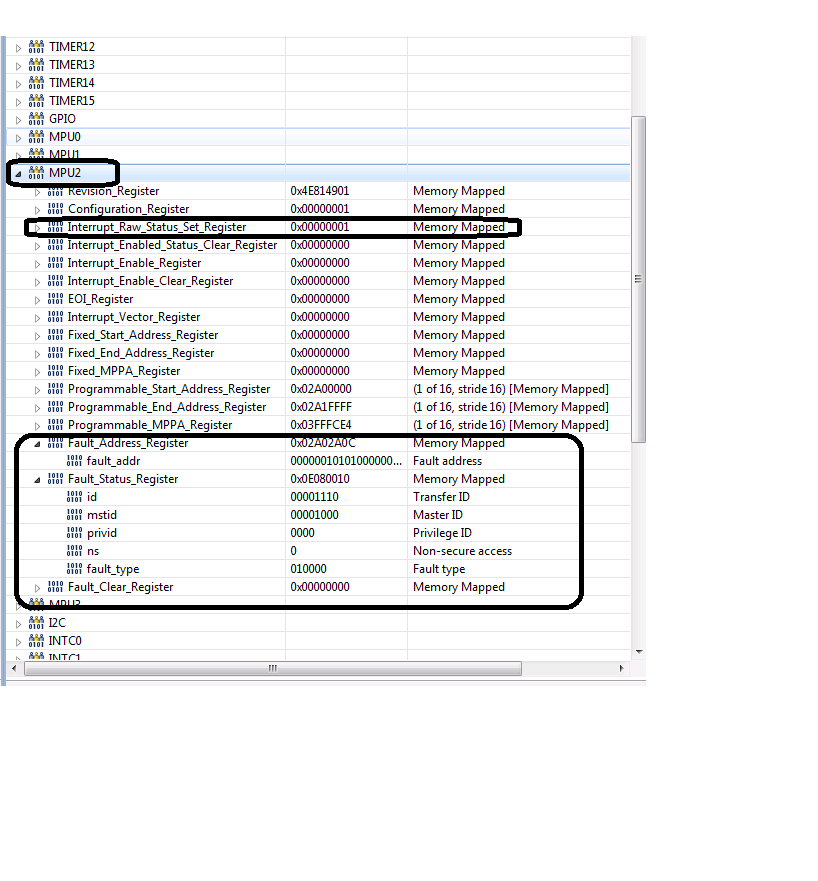

My application running on 6678 crashes sometimes. I found that the MPU2 has detected an error:
The MPU2 is for QMSS CFG port. And the address detected also falls in that range. I am not sure how I can address the issue.

  • You can find clues in the MPU2 Fault Status Register value (0x0E080010), bits field [5:0] is 10000b which means "Supervisor Write Fault" is the cause of this access error based on the description in MPU user guide. And bit field [23:16] is 0x8, so master AID 0x8 (CPU0_CFG) is the master which generates this Supervisor write fault.
    Then if you look at the PROGn_MPPA register value (0x03FFFCE4), bit field 4 "Supervisor Write Permission" is 0b which means "Access not Allowed". And you enabled AID 0x8 in MPPA (bit 18) to check for access permission.
    So probably you should set 1 to "Supervisor Write Permission" bit in PROGn_MPPA register(s) to enable the access for all AIDs which are enabled.
