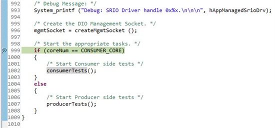

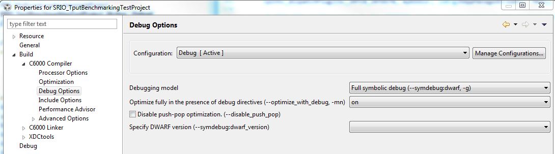

    1. Clean and rebuild the consumer and producer outfiles using the 'Full symbolic debug' option. Right click on the project and select 'Properties' >Build>C6000 Compiler>Debug Options:
    2. Place a breakpoint after the SRIO initialization, but before transfers are made. While testing, I placed the breakpoint at the end on main() in benchmarking.c (around line 999, although it might be slightly different in their code):
    3. Follow the same procedure to load and start the code on each core
    4. For each device, load the SRIO debug gel file, which can be located at the following link: Keystone SRIO Debug Gel Script
    5. Start at step 1 in the documentation included with the gel file and provide the results.
