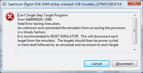

The problem is that when I run my whole program it gets stuck on this fairly simple bit of code. When stepping through line-by-line it stalls on the line:
inv_nblocks = 1/(float)nblocks;
When I step into this code and then step through the assembly (via the disassembly window), I get the following alert/error:
Considering I am just dividing two numbers this seems pretty weird.

  • Hi Jack,
    Thanks for your post.
    When you deal with writing code with floating operands, you should be compliant with both Nr. & Dr. on a fractional data and the variable which is assigned to its fractional part should also align with floating data type. I think, you should use the code as mentioned in the below format:
    inv_nblocks = 1/(float)nblocks; ------------> Wrong
    float inv_nblocks; -----------------> Correct
    inv_nblocks = 1.0/(float)nbloacks ------------> Correct.
    Please use your code in the format mentioned above written in Green.
    Then try to debug your code step by step through the appropriate debugger tool and check whether, you are able to reproduce this issue.
    Thanks & regards,
    Sivaraj K
    Please click the Verify Answer button on this post if it answers your question.
  • Hi Sivaraj K,
    Thank you for the response.
    I'd already realised that this was incorrect and had already changed the offending line to:
     inv_nblocks = 1.0/(float)nblocks;
    The problem still persists, though I noticed if I decrease the stack and heap sizes to 0x800 (in comparison to the values in my cmd file above), my code fails in other areas. Would a divide somehow use up the stack? If this would seem strange if it did.
    Jack
