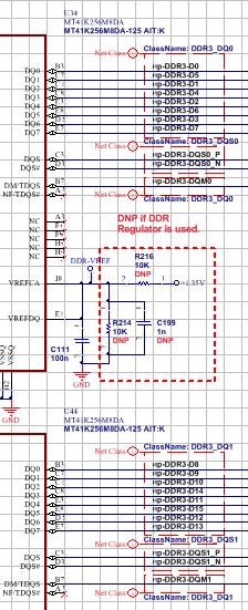

I've read a few posts on this forum about bit swapping using DDR3/L with the AM335x.  If I understand correctly it is okay to randomly swap bits in the same Byte lanes and even swap byte lanes if DQS and DQM follows the respective byte lanes.  My confusion is if a DDR3 controller is JEDEC compliant for "write leveling " which would make the Prime bits fixed and not swappable?
I have seen advice on this forum and the TMDSSK3358 which does not follow the write leveling rule.  Does this mean that hardware write leveling is not working?

In my design I would like to swap bits in the same byte lanes for layout reasons but I would like to ensure that hardware write leveling in still in play.  Please see the snippet below:
Also, the way the DRAM controller is laid out there is no way to avoid changing layers on the Databus unless you use blind vias.
