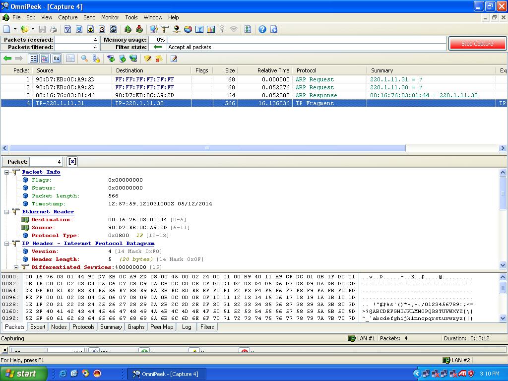

I have a problem when sending fragmented UDP messages using the NDK (2.23) on C6678 EVM, when a MAC address resolution has to be done.
The situation is the following:
   - I want to send one UDP message that must be split in 3 IP frames.
   - When trying to send the first IP packet, the NDK stack detects that a MAC address resolution must be done.
      * the IP packet is attached to the lli
      * the ARP is sent
   - then, it is tried to send to second IP packet. As the ARP response is not received, this packet is no sent and attached to the lli.
   The problem is that the previously attached packet is discarded (file nkd/packages/ti/ndk/stack/lli/lliout.c, line 357)
   - when it is tried to send the third packet, the same thing occurs: the second packet is discarded
   - finally, when the ARP response is received, the packet attached to the lli is sent (file nkd/packages/ti/ndk/stack/lli/lliin.c).
   But only one packet is attached. The 2 other packets are lost.
   Could you confirm this analysis ?
   Is there a way to send the 3 packets even if a ARP has to be done ?

  • Tom,
    I expect NDK to do the fragmentation for me: I use the "sendto" API with a size of 3000 bytes (so, I expect to have 3 frames at the output).
    The message is no sent before MAC address is known: the last frame of the message is stored until the ARP response is received and then sent. The two first frames are wasted.
    I used Wireshark to determine my findings. I attached a screenshot of the wireshark situation. The C6678 EVM IP address is 220.1.11.30.

  • Hi David,
    Here is attached the screen capture is was talking before.
    Thank,
    JP

  • JP,
    I was able to reproduce the problem and am looking into the cause.
    JP said:
    Since my last post I read in spru523H, page 57: "If sending to a new IP address, the very first send may be held up in the ARP layer while the stack determines the MAC address for the packet destination. While in this mode, subsequent sends are discarded." Perhaps this has a relationship with my problem.
    I see this too and I think you may be on to something.  It may be a bug.
    This code shouldn't execute if there is already an ARP mapping for the host you are trying to send UDP packets to.
    You can get an ARP table entry for the other host by first pinging it from the NDK/6678 host, before your task that sends UDP packets runs.
    Can you try doing that?

  • Steve,
    Thanks for your investigation.
    I'm not able to do the exact manipulation you suggest because the telnet console is not avalaible in my environment.
    Instead, I used the LLIAddStaticEntry() function to tie the MAC address of the other host to its IP address. Doing this, the sendto() that was problematic runs OK with a size of 2000 bytes.
    This is a good information, but in my application, I can't do the association IP@<->MAC@ statically or manually. I need to have a dynamic association.
    This is good news.  No worries about not using the Telnet console, this was "just an easy way" for you to be able to try the experiment.  Adding the static entry should be OK, too.
    What I think you can do in this case is run a ping from your app code to the other host, in order to "prime it" before doing the real work, the UDP transfers.  The ping command will be sent to the host's IP address, but since there's no ARP mapping for the other host, the NDK will be forced to use ARP to find the host's MAC address.
    So by the time the ping goes out, the ARP table will have been updated, which should have the same effect of the code you added in the above experiment.  Then your UDP send should not see dropped packets, since it won't hit that code you found that's dropping them in the ARP layer.
    Lastly, the NDK contains example code for sending a ping.  It's just the Telnet console's code for the ping command.  I recommend making a copy of it in your app. You would need to modify it to get rid of the "ConsolePrintf" calls, though.  Also, that ping command will send something like 5 ping packets.  You would just need to change it to send a single ping.
    You can find the ping example code in:
    ti/ndk/tools/console/conping.c
    Steve
  • JP,
    For the record, this issue is being tracked by the following bug:
    SDOCM00088612 ARP Resolution Queue Len is 1
    Steve
