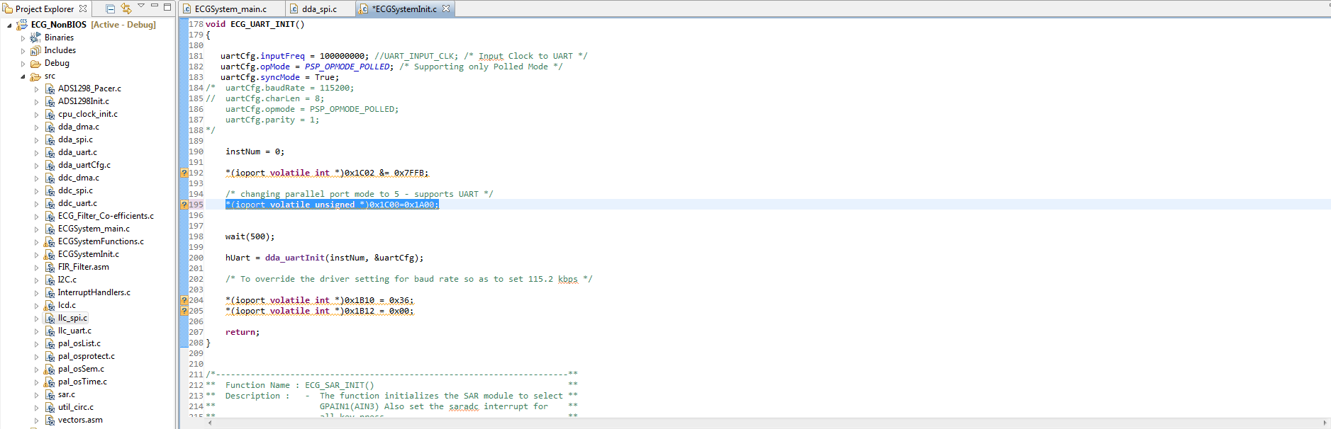

We have a crucial problem. We are working on the original ECG code provided by TI  (http://c5505-ezdsp.googlecode.com/files/ADS1298_ECGSystem_C5515EVM.zip) . This code uses PPMode=5 which includes UART and LCD to show ECG signal. However, this mode does not include the other SPI CS, only SPI CS0.

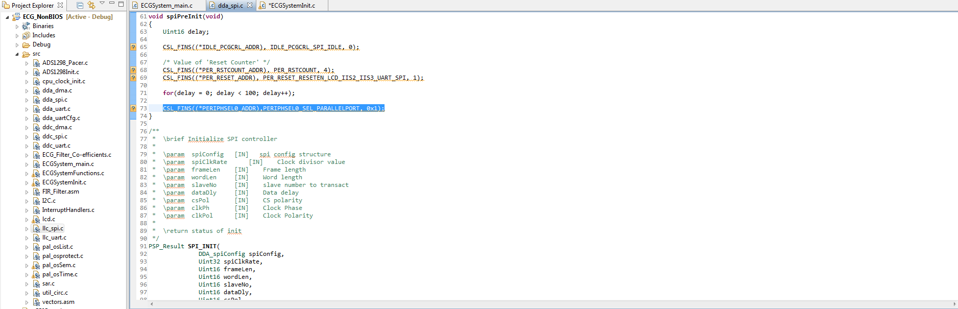

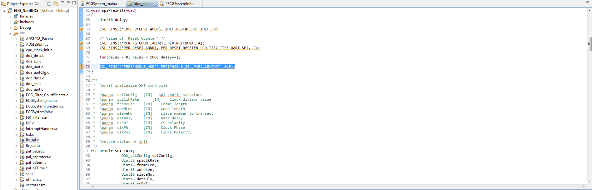

We desire to run this code by using SPI CS1.

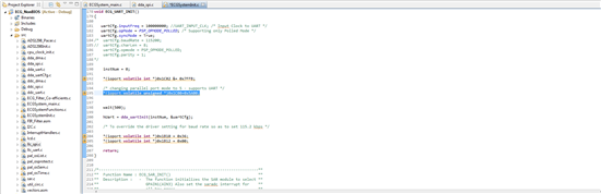

Because pin multiplexing is necessary, we firstly changed PPMode from 5 to 1 which supports SPI CS1. Another reason of selecting PPMode=1, this mode also supports UART. So, if we run the code successfully, we can observe the ECG signal on computer by using C55x ECG ADS1298 Medical Development Kit (MDK).exe.
PPMode=5;
PPMode=1;

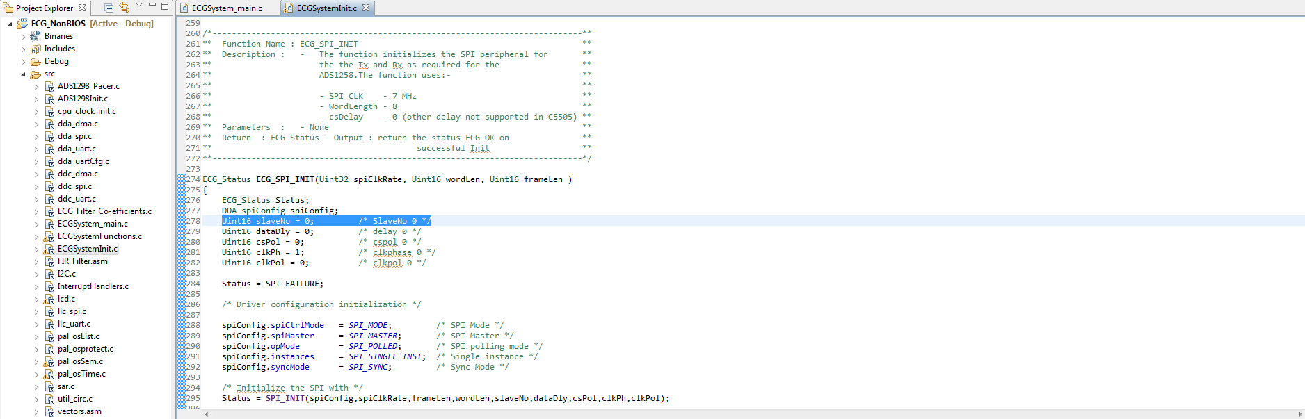

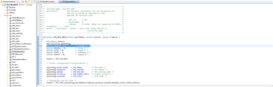

Then, we change the slaveNo in order to select chip select no. We changed chip select no from 0 to 1. These modificiations which we made are related to code.
CS=0;
CS=1;
