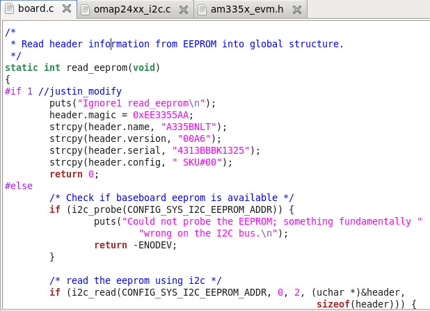

Our Target Board canceled the EEPROM
I use BB BLACK + SDK6.0 of UBOOT do the following tests
1 Setting header information to the board ID struct

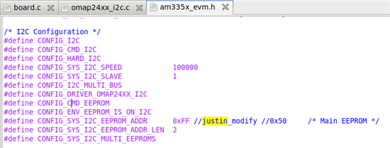

2. Modify the EEPROM address, making uboot-spl impossible to read the BB BLACK of EEPROM

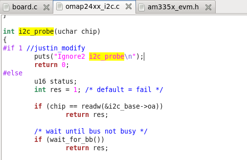

3 Modify the I2C DRIVER
4.when UART Print half (Ignore2 (XXXX)) it is Crash!!
How to solve??
