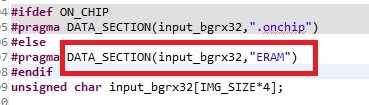

I want to allocate my data buf on DDR memory space on C6678 using DATA_SECTION.
But when I see the xx.map it seems that my data buf is not in DDR space but in L2SRAM .
why? Below I post my cmd file, DATA_SECTION and map file.

David George,
Please try the below sequence at cmd file for Memory and Sections. Next rewrite Pragma call at your ".C" file.
/* Memory Map */
MEMORY
DDR3 (RWX) : org = 0x80000000,len = 0x07000000
SECTIONS
.testMem > DDR3
#pragma DATA_SECTION(input_bgrx32,".testMem");

In the application linker command file or XDC configuration place the input_bgrx32 (testMem) into external memory.
If using XDC .cfg file to add sections to the linker command file: /*Create our memory map - i.e. this is equivalent to linker.cmd */
Program.sectMap[".testMem"] = new Program.SectionSpec();
Program.sectMap[".testMem"] = "DDR3";
If explicitly placing the input_bgrx32 in the application linker command file:
.testMem > DDR3
Please see this wiki article for DATA_SECTION. In this example code used another family TI device, not C66xx. You can take this as a reference.
